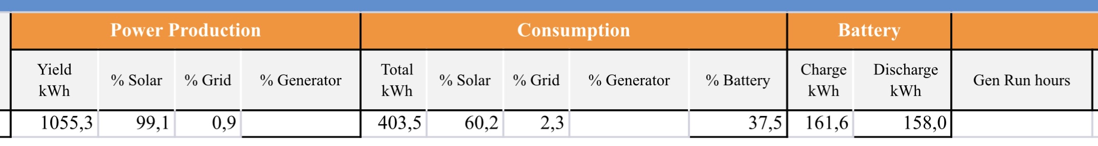

I exported the “production report” from VRM for june, and the discharge/charge figures under battery give me a 60% round trip efficiency. I understand where that comes from, with relatively low consumption and a three-phase system’s idle consumption, and high charging power from the AC coupled PV, but still, that is a sad number.

I just went with what the Cerbo told me, and I could feel the heat on the metal case so have little reason to doubt that 81.5 efficiency number is correct. My Growatts are pumping 5kW all day and are cold, and silent. You’re absolutely right though, the battery itself could have losses as well - it was at 39C after that discharge cycle. I probably don’t even make 70% for round trip considering all that.
