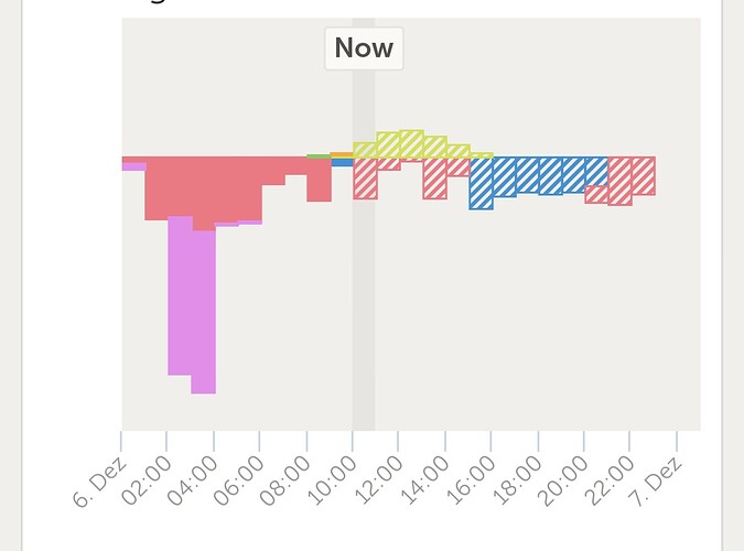

Thx very much dognose!
Btw, I increased max. charge rate from 5.2 to 5.8 kW in DESS setting, because this is the max. charge rate at grid side. (battery side only 5.2 kWh)
will check, you can remove the number.

Thanks for the clarification. My feeling wasn’t wrong after all and something else wasn’t OK

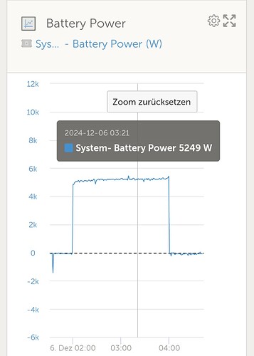

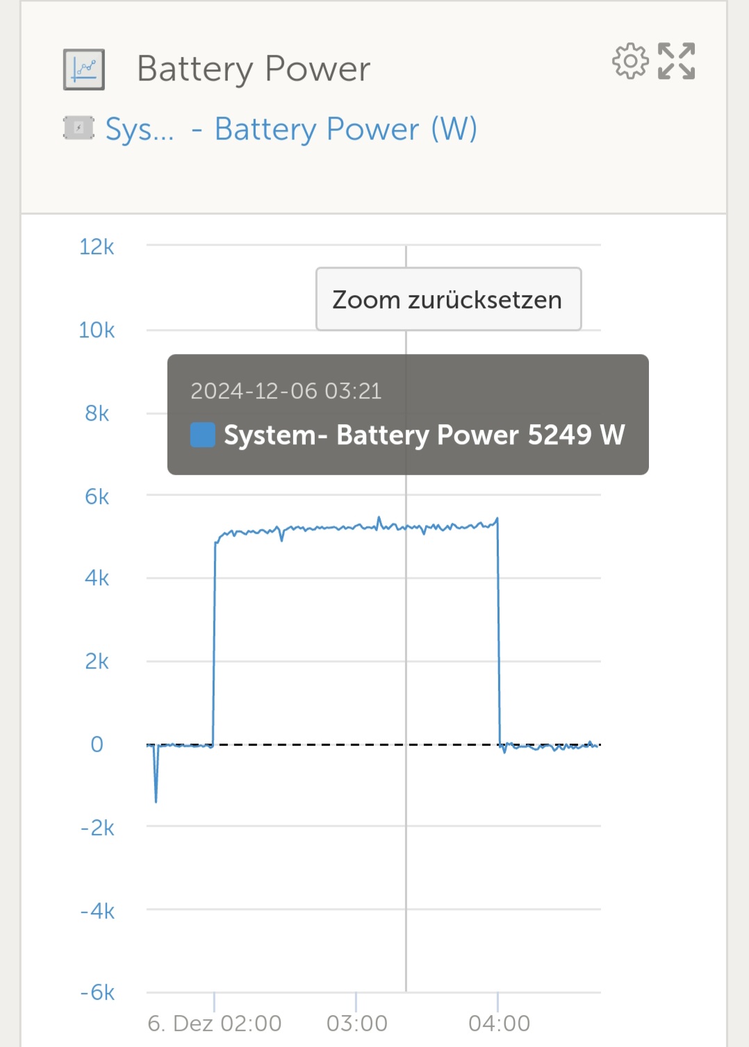

Maybe that will actually help. It hasn’t been running like this for long, but last night battery was charged continuously for 2 hours without a break, without taking anything from the battery in between.
This means that the “grid-side” 5.8 kW is parameterized as the max. charging rate in the DESS settings, whereby the battery itself is actually only charged with 5.2 kW due to the losses. Let’s keep watching…
I have set charge power to 7.9 kw (1 hour grid to battery is 7.8 kwh, charge power is 7.5 in advanced view)

If you are charging for 2 hours try to take the average of the grid-side values.
For my system I investigated several 3 hour charging intervals and calculate the average of the grid-side values to:
(3.97 + 3.66 + 2.33) / 3 = 3.32
I took the maximum of all calculations for Battery Maximum charge power. This setting seams to work for my system like a charm.

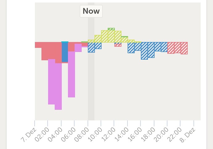

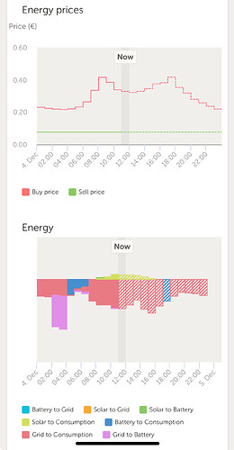

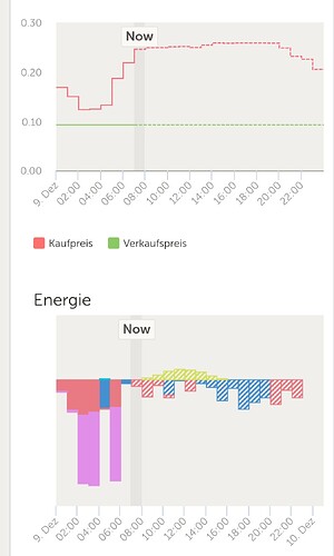

Too bad, an incorrect entry of the max. charge rate is definitely not the cause of the behavior. Last night the same thing again: it was supposed to charge continuously for 3 hours in the cheapest hours.
However, after 2 hours of charging, it actually discharged for an hour and then charged again for the next hour at a higher price!!!
This is complete nonsense!

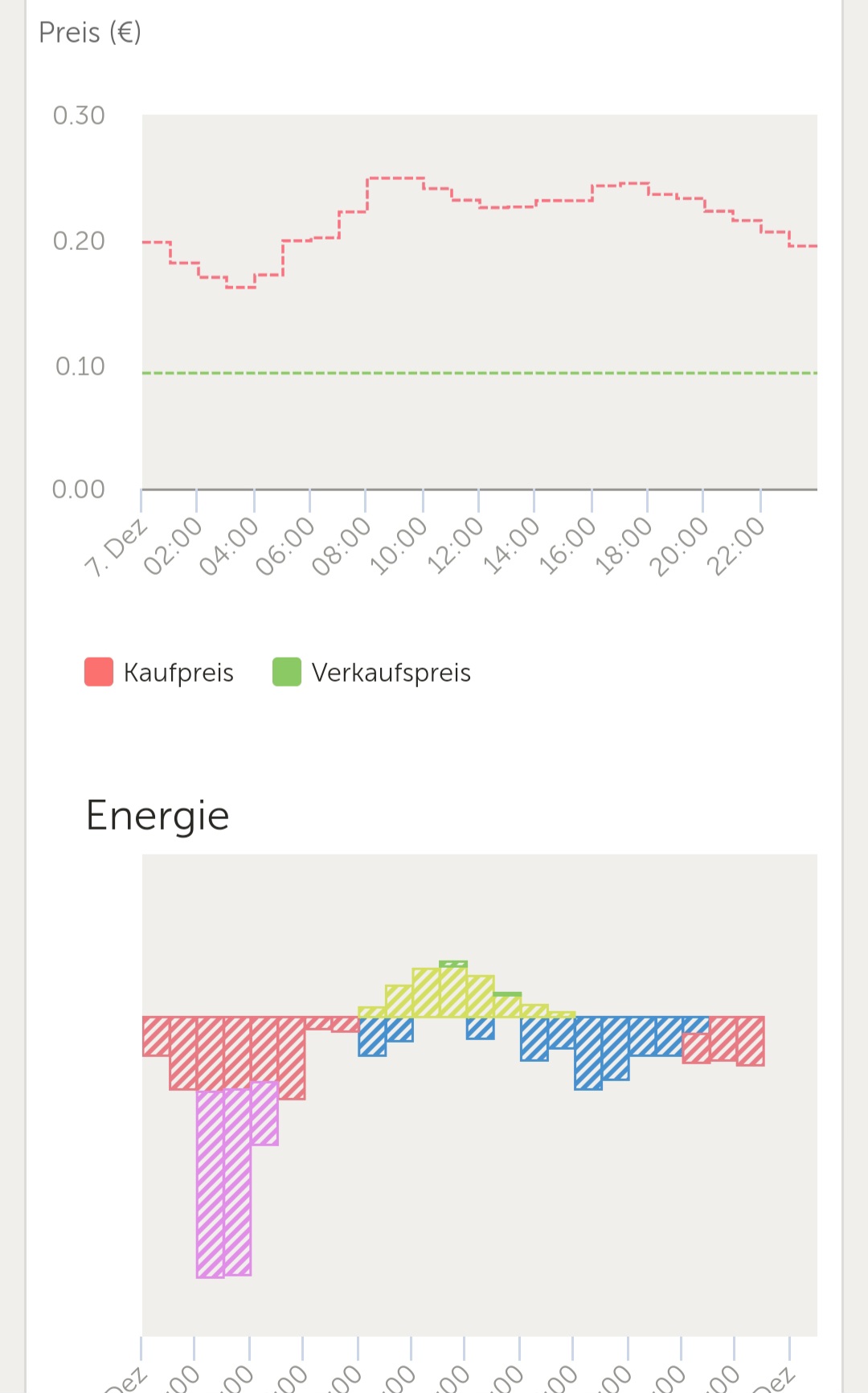

We had slightly different price conditions so my system only charged for 1 hour. But everything was perfect
Nearly perfect on my side as well:

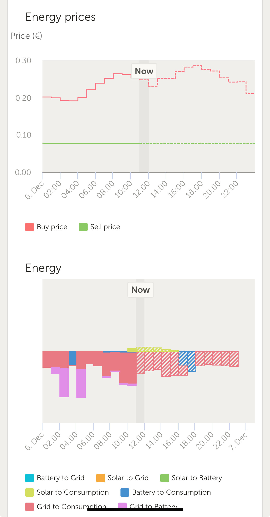

Last night the same problem! 3 hours of continuous charging planned. In reality, however, the battery is only charged for 2 hours, but the third hour is spent discharging the battery instead of charging, even though the purchase prices are still very favorable. Then the battery is charged again at much lower prices from the grid! Isn’t that absolute nonsense?
@dfaber @Barbara Your developers really need to take a look at this, it might actually be a systematic DESS problem?
