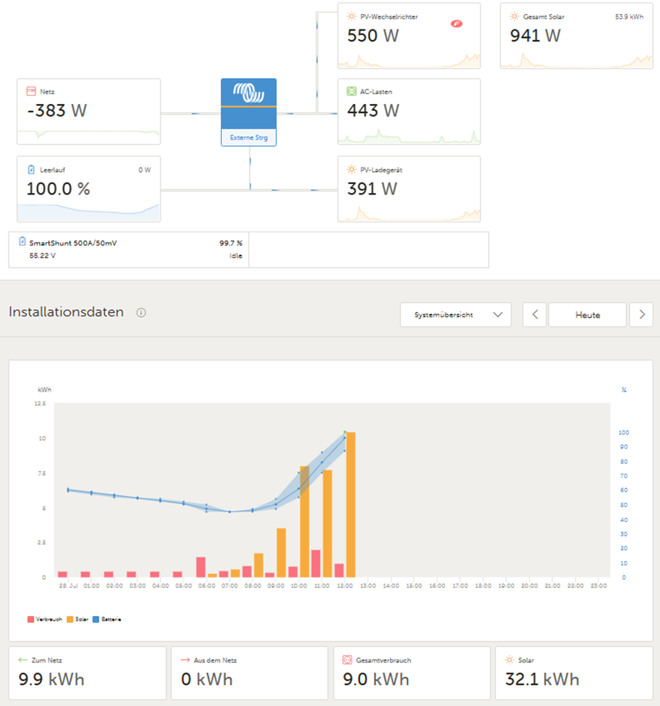

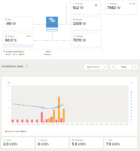

Here´s a screenshot from now today (9.a.m) with DESS off:
This screesnhot is with DESS on:
Weird? isn´t it? Why is the system cutting of the AC surplus? Before it was feeding in the grid. And when battery is full, the MPPT will also be cut off.

Here´s a screenshot from now today 1p.m with DESS off:
Now you can see, battery 100% AC-/DC-surplus is cut off unfortunately, while I could feed into grid approx. 13kW… :frowning:

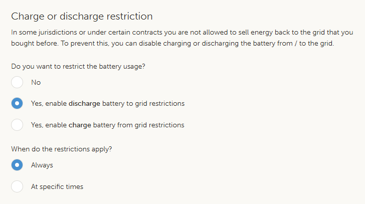

For battery restrictions there’s another setting. I think DESS can do this now with the latest update that enabled Dynamic power limiting on PV inverters.
This is the setting you’re looking for, DESS → Battery (this prohibits discharging the battery to grid while allowing PV power to export)
Hi Nani,
yes that´s absolutely correct. This was already activated in my settings.
So my fear to do something illegal was totaly arbitrary.
Anyhow, thank you very much!
