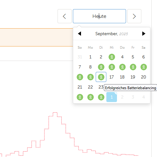

My Dynamic-ESS does Battery Balancing for several days in a row. Does anyone else observe this behavieour?
I was running the DESS GreenMode now i changed to TradeMode (to optimice the cost regading to my suply contract).
The Balancing is scheduled for every 14-days. But now my solar production is high enough to fully charge the battery every day so there is no need for a triggered balancing.
The ESS battery control ist set to “optimized without battery life”
NodeRed is running, without the DESS-api.
I using mostly the Beta-VRM page, could this have an impact?
Any hints what i could have missed?

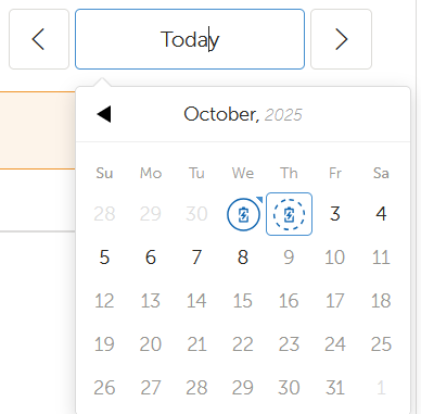

But I had battery balancing today and it seems to be planned tomorrow once more.
  • ESS setting is “Optimized without BatteryLife”
  • 60 days balancing cycle
  • Balancing was successful today
Today, one day later, it shows battery balancing yesterday as green, but plans to do it again today:

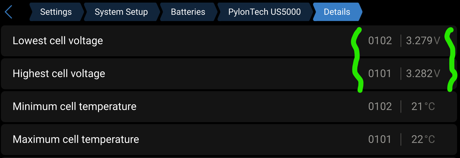

My two PylonTech US5000 seem to be well balanced
