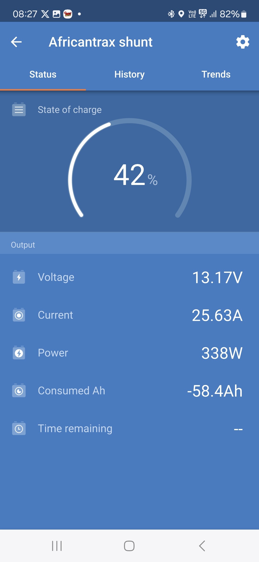

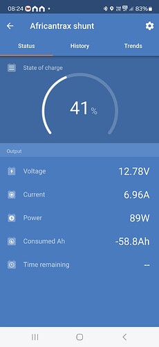

I noticed recently that my DC/DC 12/30 only charges my Aux battery at max 10Amp. I have a standard alternator. By chance I disabled the Engine shutdown detection and my charging current jumped up to around 27Amps. What am I doing wrong, and will I drain my start battery If I leave this setting disabled?
You need to tinker with the voltage setpoints of the engine shutdown detection. If the orion derates then it is operating inbetween point 2 and 3 of the diagriam
Input voltage might be a tad low, so the input current gets reduced
