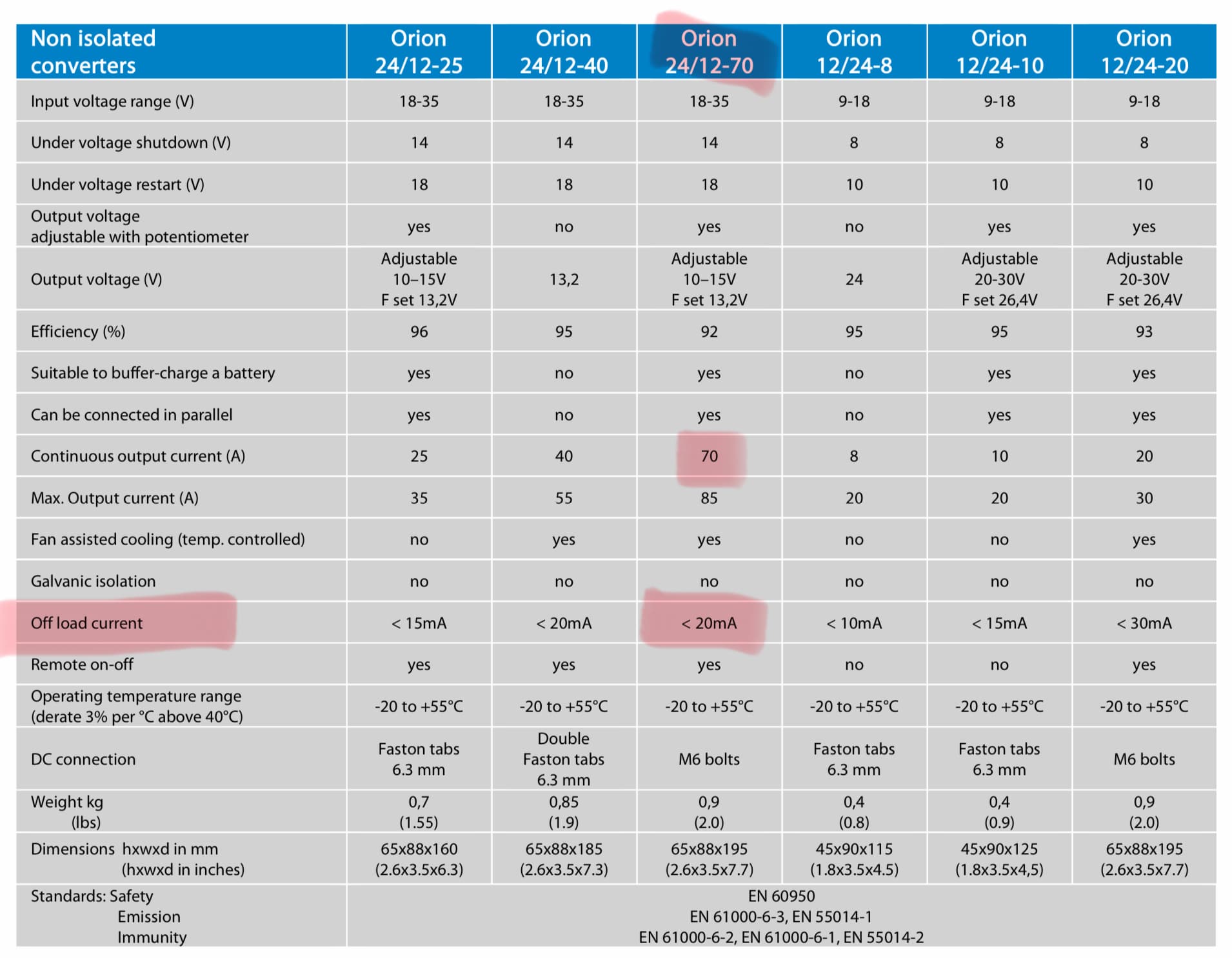

Data sheet says current draw is <20 mA when off (see below) using the remote switch.
But that is not the same thing as when it is on with no load.
Someone would have to measure it.
12 V * 0.020 A = 0.24 W
13.8V * 0.020 A = 0.276 W
