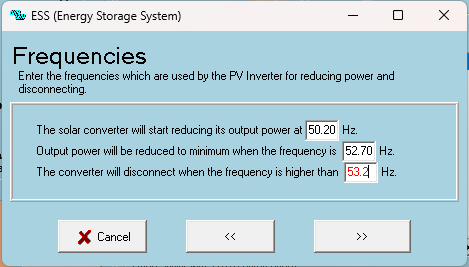

Hi,
@Dognose: thank you already for this information !
If I change the parameter in the ESS assistant as shown in the image: will that resolve the issue in our case? In other words: will the Multiplus-II then briefly push the frequency to 53.2Hz before dropping to 50Hz when reconnecting to the grid?
Yes, that is what the Multiplus then will do.
As long as the Issue on the Fronius side behaves as described, that should then force the Fronius into it’s grid-reconnect-delay, when frequency is lowered again.
You could test once at a soc < 100%, and watch the Fronius display.
If it still doesn’t work, your battery should catch that without overvoltage-issues, given you obeyed the Factor 1 Rule.

Fronius has increased to 53.1 Hz, not 53.0 Hz. So in ESS it should be 53.2 Hz, not 53.1 Hz?
Fronius increased to 53.1 right - so 53.1 should be “enough” to achieve the disconnect. Considering measurement imprecisions on both sides a higher value may make sence. Will ask our Fronius-Expert to review if that should be accounted for in the documentation, it may even be suspect to manufacturing / measurement tolerance on either side and individual units.
Exactly this were my thoughts :grinning_face:
I increased the ‘converter disconnect frequency’ to 53.2Hz in the ESS assistant and tested on-site. The system now does what it has to do: the Fronius stops producing during the minute the Multiplus uses to reconnect to the grid.
@dognose : thank you for your help !!
