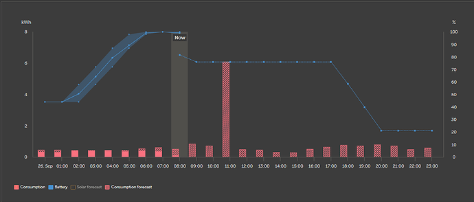

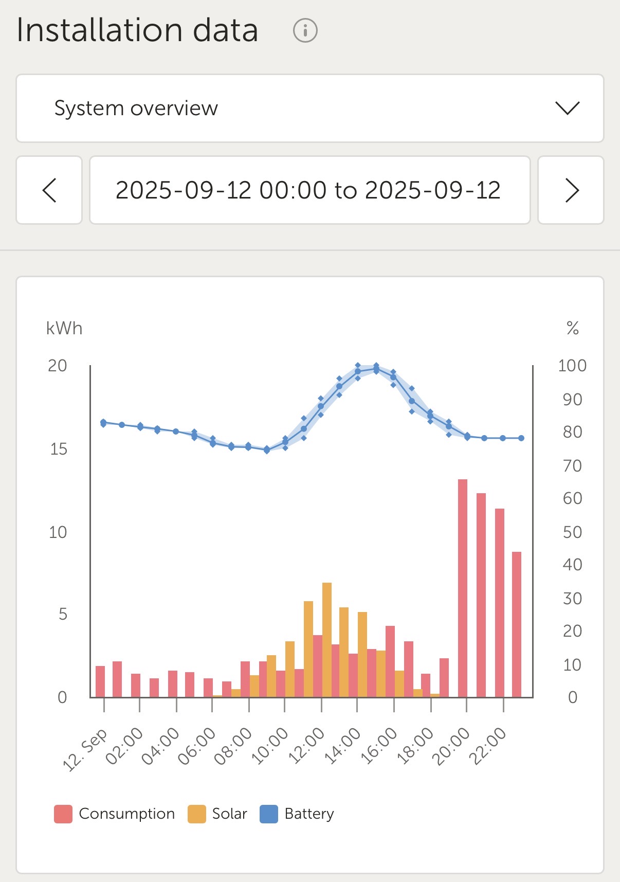

I have a programmable clock that starts my tapwater heating every day at 11.00 hour. The heating takes about 45 minutes and is about 7 kWh of energy. If I look to the consumption forecast than I see daily a forecasted consumption of about 7 kWh that is between 10.00 hour and 10.59 hour. That is one hour to early forecasted. See picture below. Is this a bug or do I have to change a setting?
The next day I see the same. The consumption forecast is between 10.00 and 10.59 hour, but the real consumption is between 11.00 and 11.59 hour.
It is every day one hour difference between the forecast and the reality. See picture below. I think this is a bug in the forecast. Can someone react on it.

My water heater is scheduled to work from 5:00 to 7:45 and from 12:30 to 19:00.

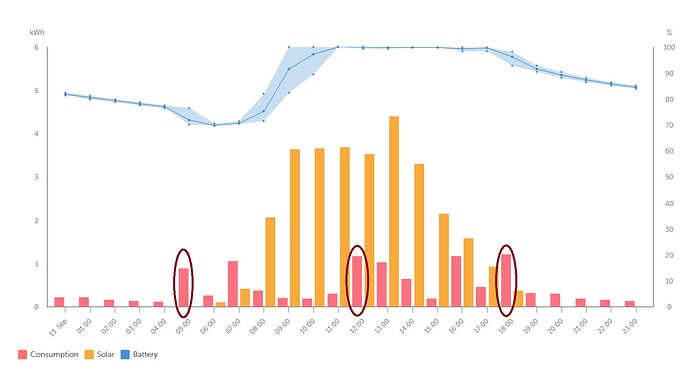

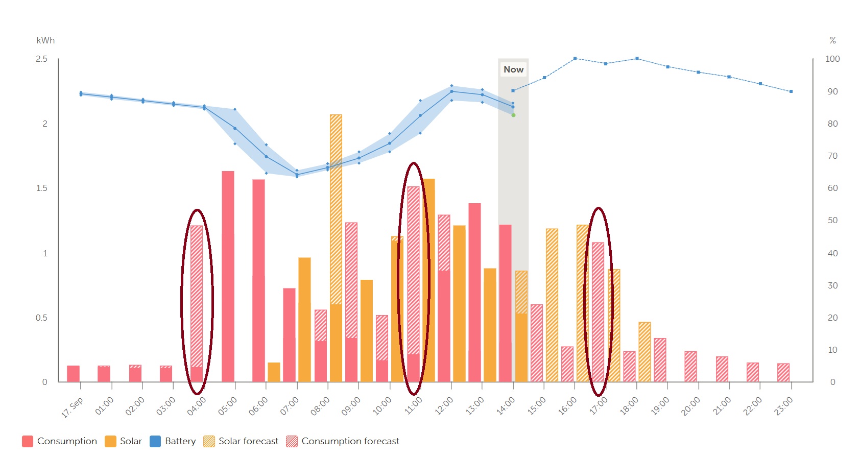

In the 1st picture we can see consumption forecast that shifted 1 hour back compared to actual consumption:
  • 4-5 instead of 5-6
  • 11-12 instead of 12-13
  • 17-18 instead of 18-19

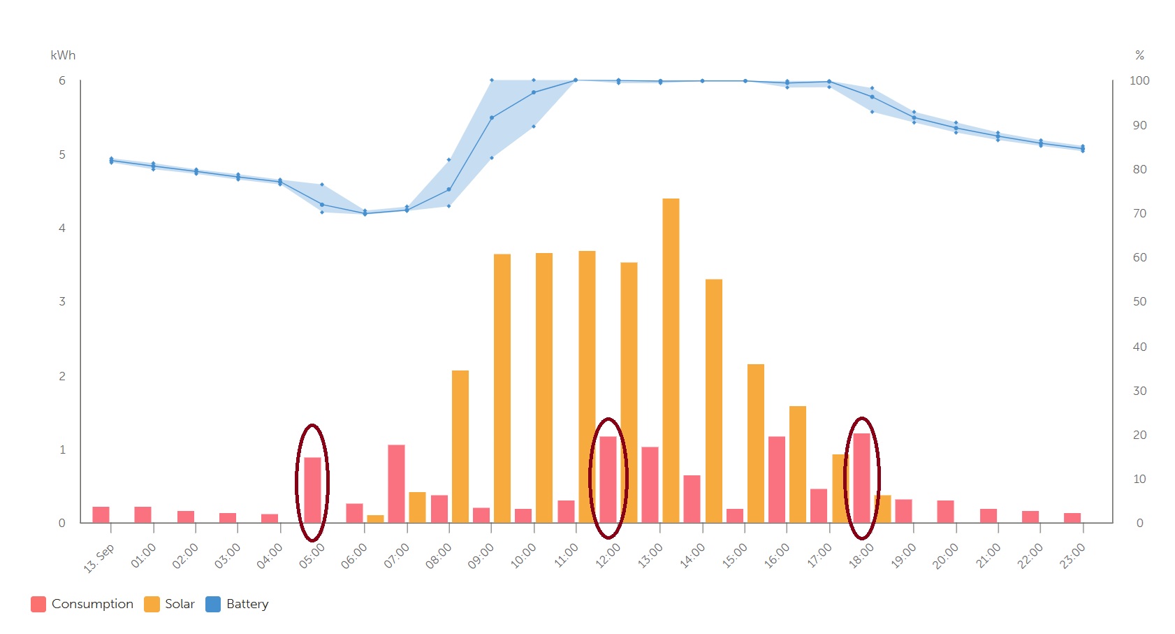

And the typical actual consumption is shown in the 2nd picture.

My off peak period begins at 20:00. Last Friday we charged our EV starting 20:00.
Tomorrow (Friday) the projected consumption jumps one hour early (19:00).

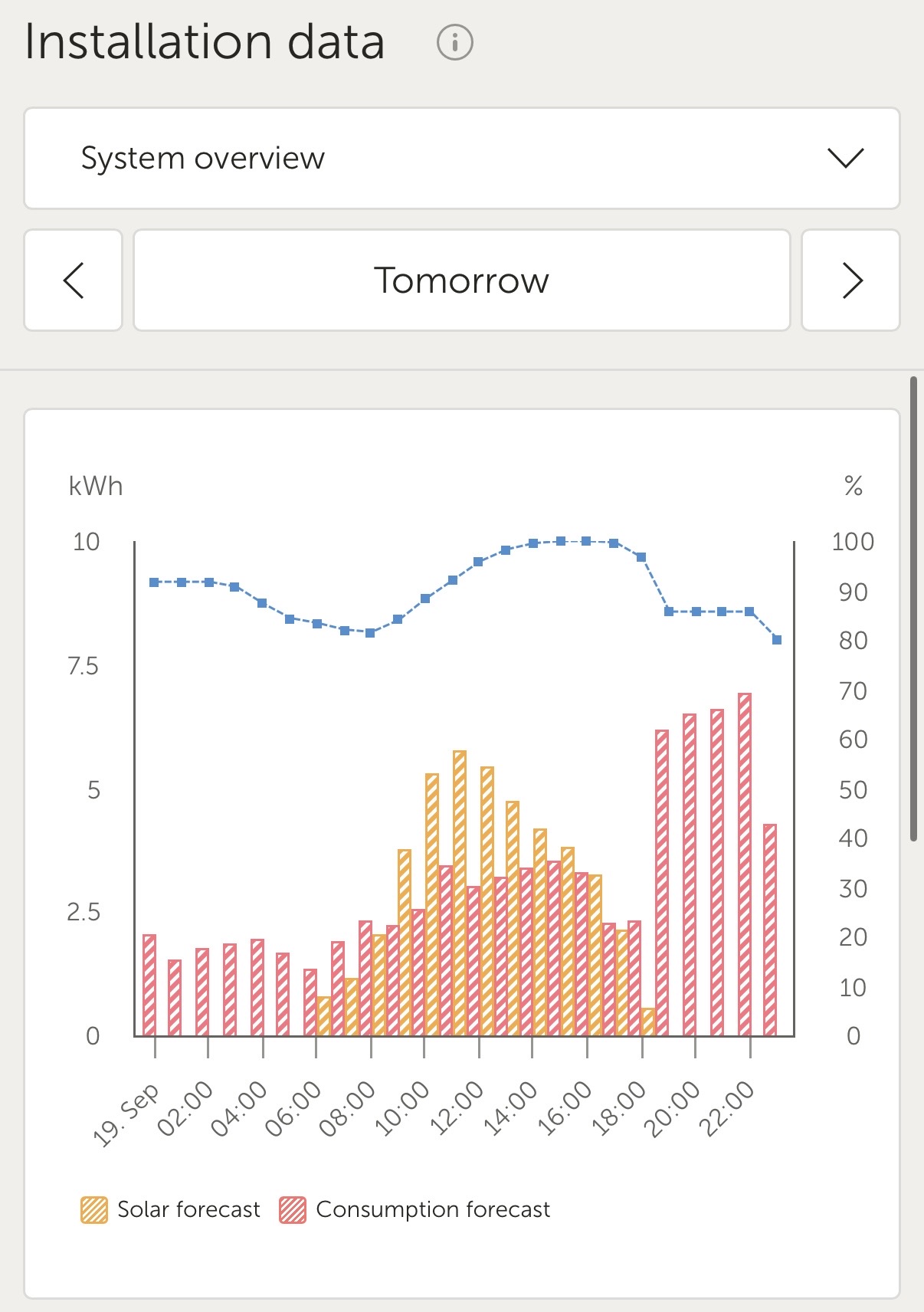

This morning about 8.00 o’clock I made a screenshot of the forecast. See picture below
The forecast is 6.1 kWh between 11.00-12.00 hour. The forecasted time slot is ok now.

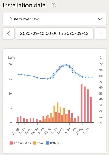

The real consumption is 8.43 kWh between 11.00 and 12.00 hour. see picture below. So the timing of the forecast is ok now but the forecasted cosumption is a bit low. Normally I have a consumption of 8-8.5 kWh (but the case is about the timing of the forecasted consumption)
