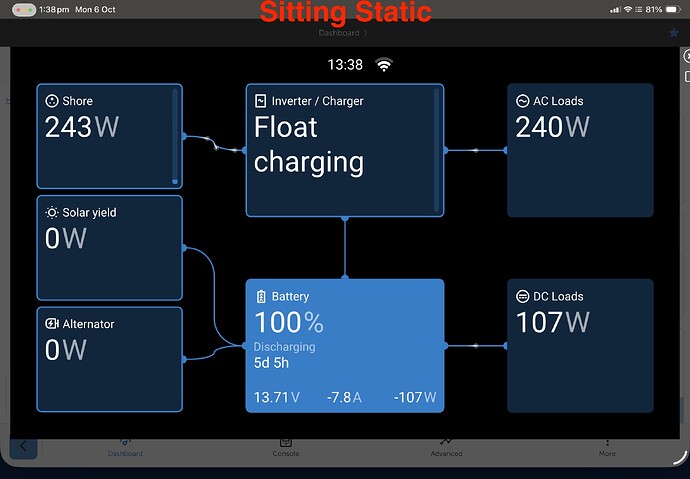

I’ve moved my system to a new RV which has a constant AC load of approximately 240W. Even on sunny days with ample solar available (1040W array), the system continuously draws this 240W from the grid. My goal is to power these loads from solar and the battery bank, only using shore power when necessary.

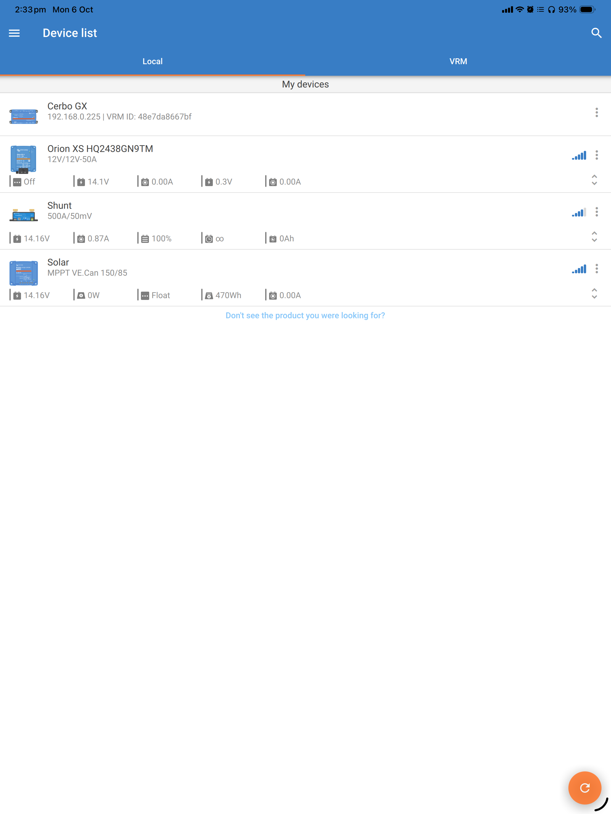

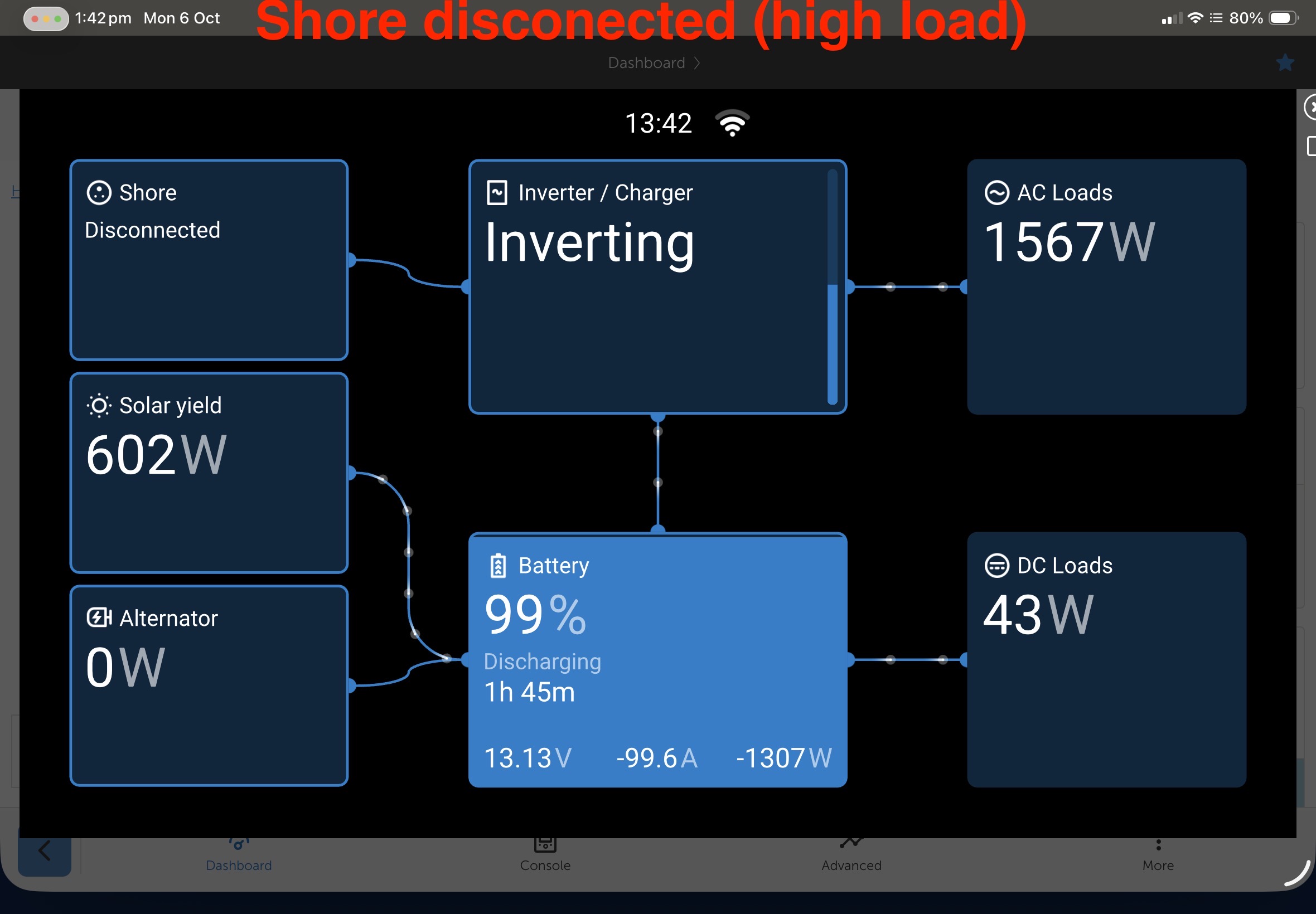

The system works perfectly off-grid, running the loads from solar and battery as expected. I have attached screenshots showing the available solar power when I disconnect the shore line.
