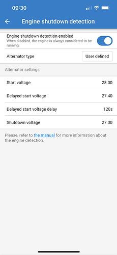

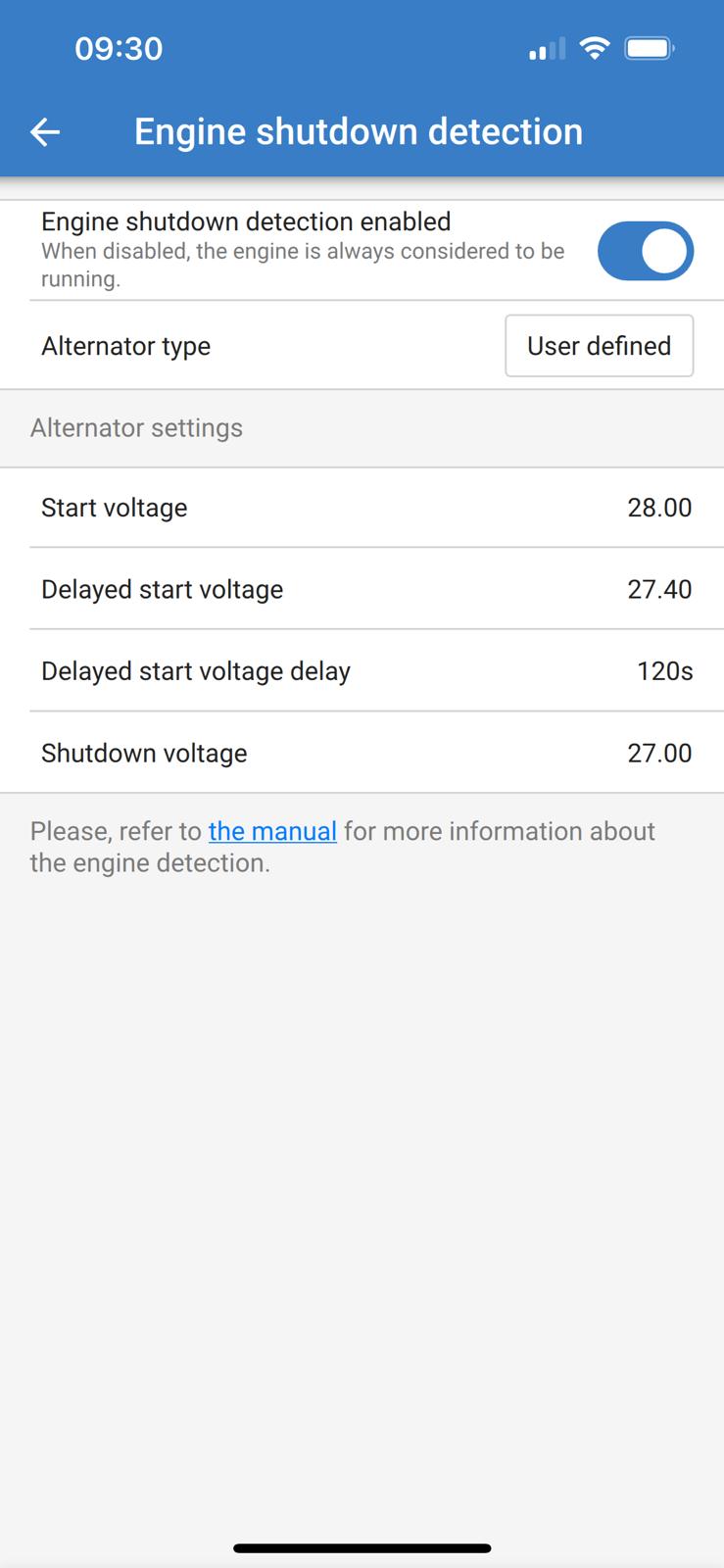

There is some settings value to control to be sure for the Engine start detection and the status on the main battery.
All settings can be followed and tune using the VictronConnect.
If you follow the manual you will find the reason why it do not start up! (perhaps the batteries voltage settings, …)
==> 4. Installation

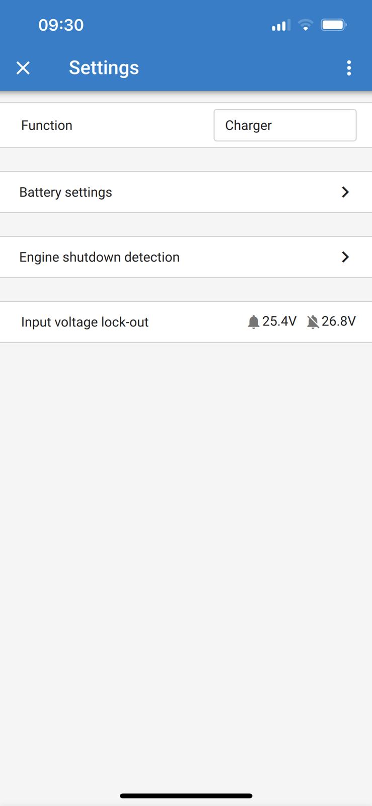

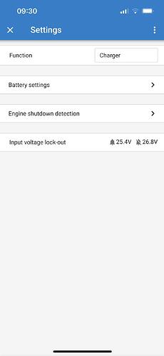

In my case, 24V installation, I use to tune a bit the value to get the charger to startup with engine start detection…
This is an example, this one is for my system configuration.
