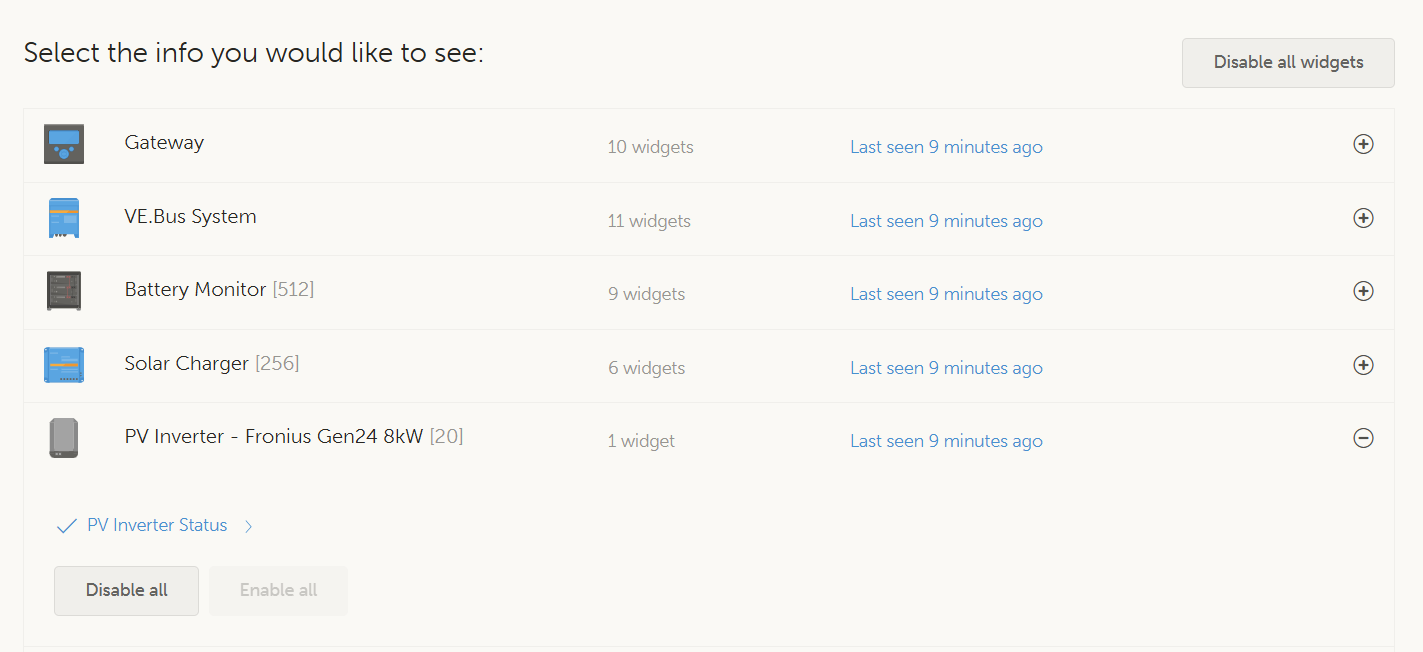

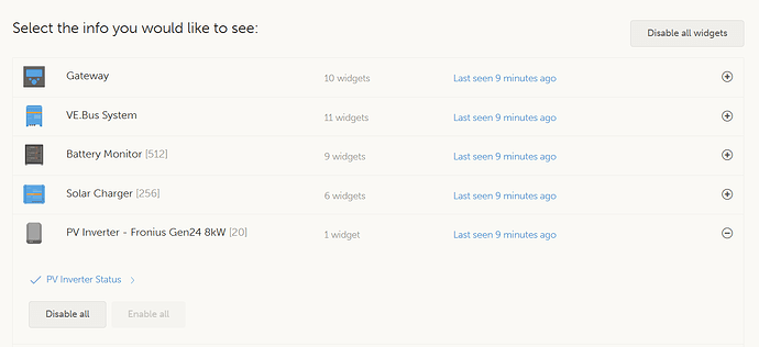

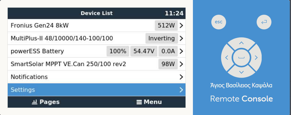

I have Color GX with firmware 3.62 (I tried this firmware to see if the problem is solved but it persists) and a Fronius Gen24 8kW. Although Fronius appears in the list of devices, together with the Watts produced at the time, it does not appear anywhere else. Not in the GX graphic UI, nor in the dashboard real time view, nor in the dashboard System Overview. When in Advanced only one wizard appear for Fronius, PV Inverter Status, nothing else.
I noticed when I had the previous firmware that instead of one, I had two devices for Fronius, one as Gen24 and one as Tauro with different solar productions each

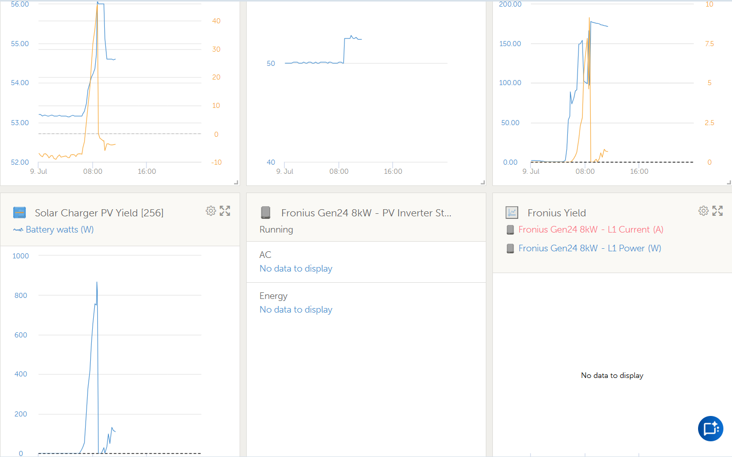

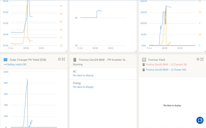

Screenshots can be found in the previous topic appearing at the beginning. We have tried all versions of firmware to the CCGX, including the 3.70beta with the same results. Fronius appears in the list of devices, but all data in AC Phase L1 are missing compared to the other installation. In the Device screen Fronius appears as: Product Fronius Tauro, Name Fronius Gen24 8kW and Product ID a142.
When looking into the production and consumption data:
When the sun rises and the batteries are filled up consumption appears from nowhere, everyday the same period of time
At the same period of time Fronius production (from solar web because there is no data nor widgets in CCGX) and smartsolar production:
When looking into Solar Charger Summary Solar Yield was 1.07kWh (up to now) and 1.84kWh yesterday.

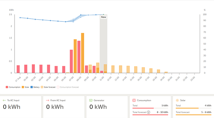

At the same period the consumption:
The figures do not make sense. Following are yesterday’s data:
Production for yesterday was 7kWh. Fronius (from solar web) was 6.09kWh and Smartsolar 1.84kWh. The two sum up to 7.93kWh.
