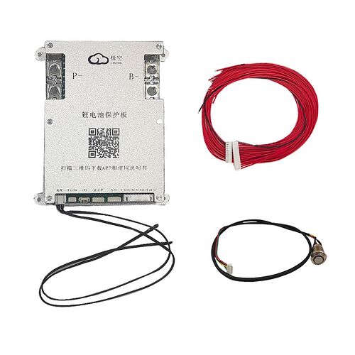

I would incorporate a bms on your lfp cells for protection measures ( under voltage, overvoltage, overcurrent…..ect but most important to balance the lfp cells. Jk bms 4~8cell could be considered.
