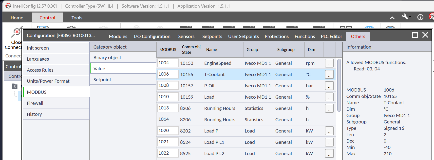

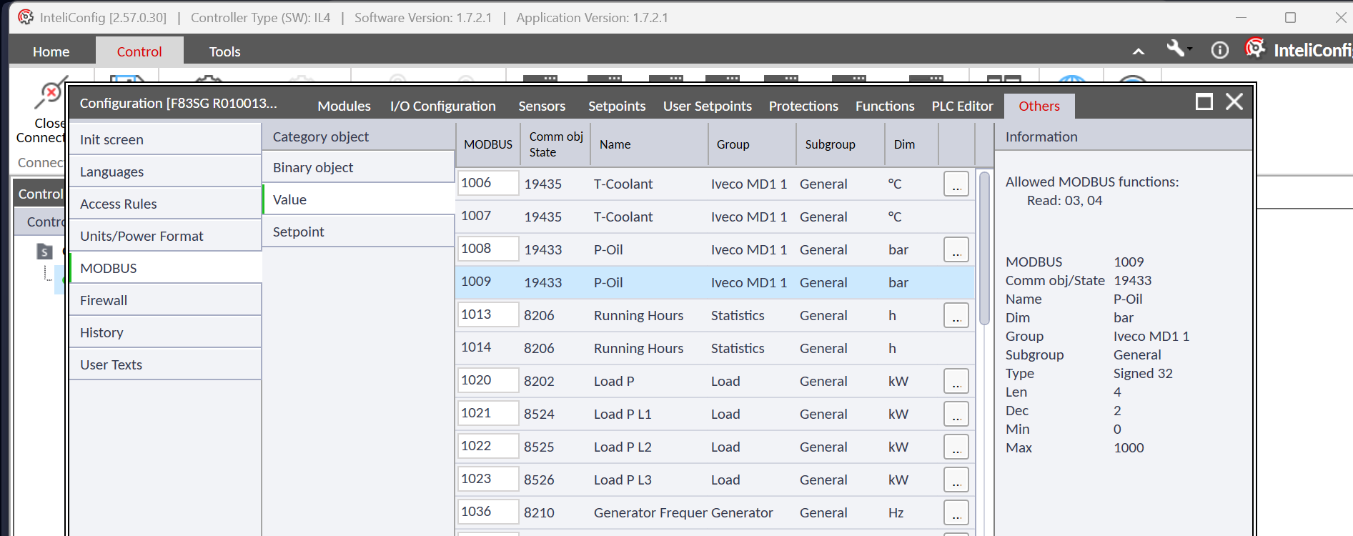

Specifically for the ComAp-ECU-Module I’m using (Iveco MD1 8.4.0.1) there seems to be a change in the data types of the two holding registers “Oil Pressure” and “Coolant Temperature” - I have a configuration archive of the old controllers, where this data shows up perfectly fine in VRM in my running systems, but when I upgrade the controller version of this archive using InteliConfig, it remaps the communication objects to new ones (the old ones don’t seem to exist anymore) which are of the data type “Signed 32”, and not “Signed 16” like the Cerbo expects.
Could Victron add support for the 32 bit values for the parameters “Oil Pressure” and “Coolant Temperature”?
