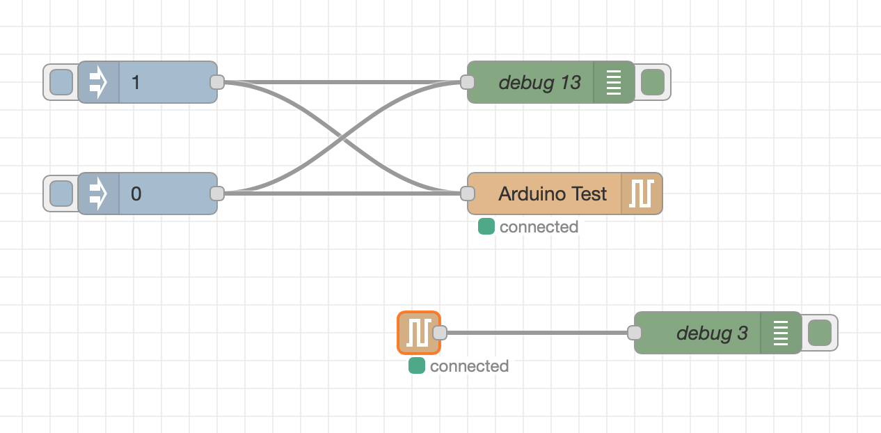

I have succesfully setup communication between Cerbo and MQTT relays via Node Red.
I have also created a flow for arduino using a Serial out.

Well, how do we explain that on my first attempt with Arduino nano the serial communication worked perfectly turning ON/OFF any digital pin?
Nothing special was done in Node-Red, just the following
It did not work with a a clone nor with a later genuine model though so I followed some instruction from the web using SSH, something like verifying the USB assignment, prioritising it etc.
Since then even the first perfectly working Arduino refused to function.
