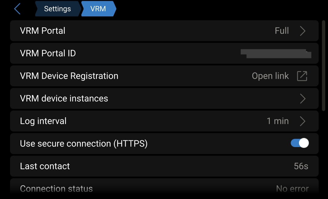

Try switching off HTTPS: for some mobile hotspots that helps.
The error is often a routing or DNS issue.
Thx LX,
Is this a phone or Cerbo GX setting?
If latter, where can I find this HTPPS setting?
Sorry, Fat, cold, fingers HTTPS.
No worries. It is done on the cerbo. Not sure what gui you are on. So if it is classic it will look different.
Settings - vrm - item #6
