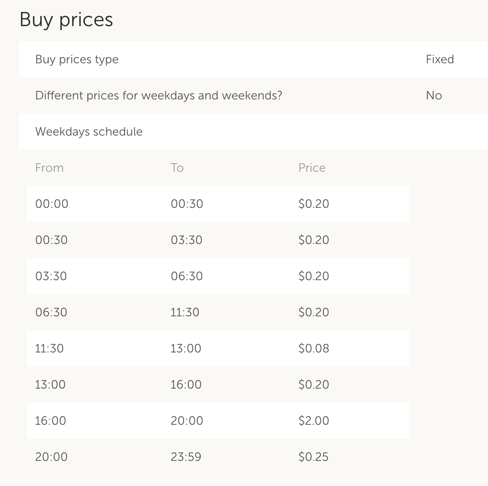

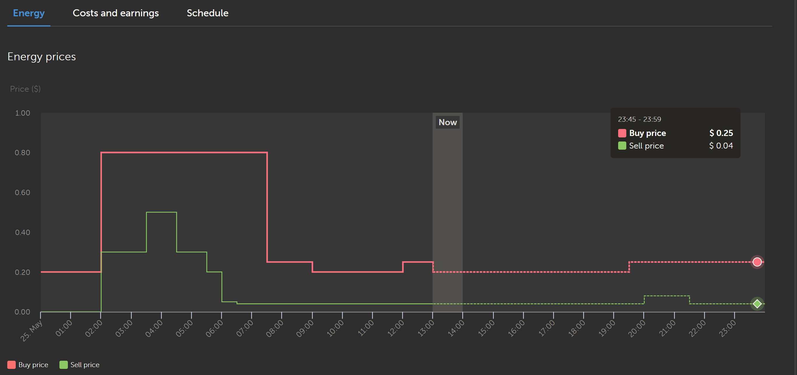

Hello,
I am in Australia.
I setup DESS with fixed prices.
Display correctly on the dashboard, I noticed the system exporting when it should not - during negative pricing, looks as though it is treating me as being in GMT, not AEST. I confirmed location on cerbo and VRM portal is east coast Australia. I saw no update to the times on the dashboard. Then changed the fixed prices times to GMT, Hoping it is a display problem. Dashboard still not updating. Letting it run today and keeping an eye on it. Two problems, dashboard not updating and time being GMT for buy and sell fixed prices. Any assistance welcome please.
Hi @IHeartSpreasheets. First of all the system should work in your local timezone.
Can’t deny we never had issues with the different timezones, but afaik those have all been resolved.
Can you provide some more clear screenshots, with your system set to your local AEST, showing what you isn’t what you expect? And verify the table of prices of my screenshot.
Lets just only focus on buy prices first. If we get that to work correctly, I am sure the sell prices will follow. This table below:
Is that reflecting the prices in your timezone?
