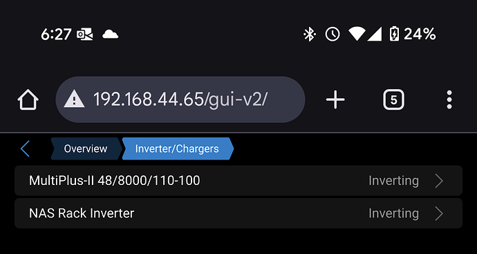

I have an MP II, and a Phoenix 1200VA inverter connected to a Cerbo -s GX. The Phoenix is connected via VE.Direct.
Both are attached to the same battery
