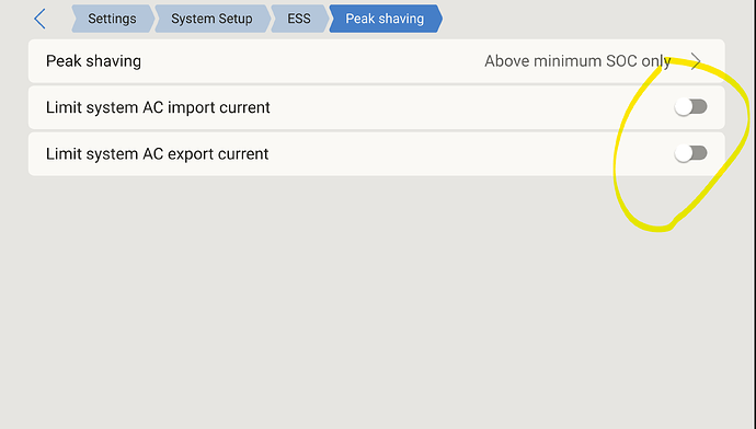

You could at least set the current above which peak shaving should occur.
If i’m not misstaken, a setting like this won’t cause any peak shaving bellow 40A per phase.
Hey Dognose I appreciate your responses on this topic.
Your suggestion does work, I have tested this at various current settings to validate it does actually affect the operation of the peak shaving function as expected. In my case the maximum I can set it to is 50A, when my actual grid connection allows 100A. Turning the function off doesn’t actually turn it off, instead it just seems to operate peak shaving at the maximum settable value, i.e. 50A.

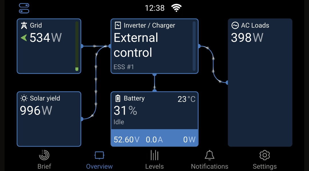

Sorry for bringing this up so late, but I’ve just read this message, I’m not entirely sure about this, to prevent this issue my home assistant automatically set multi in ess mode 3 when the battery is depleted, or idle due to low grid price, when in external mode the inverter is turned off and I save the vampire drain.
But when the multi is in external mode and there is a grid fault I don’t even notice it, it means that the inverter is capable is turning on before any electrical appliance even notice, so I don’t think the extra ms gained by keeping the inverter on are worth the extra comsuption.
Probably keeping the inverter on was a way for the developer to keep a safety margin but maybe not necessary in the end?
Maybe I don’t remember it correctly, but I can easily try it for confirmation.
