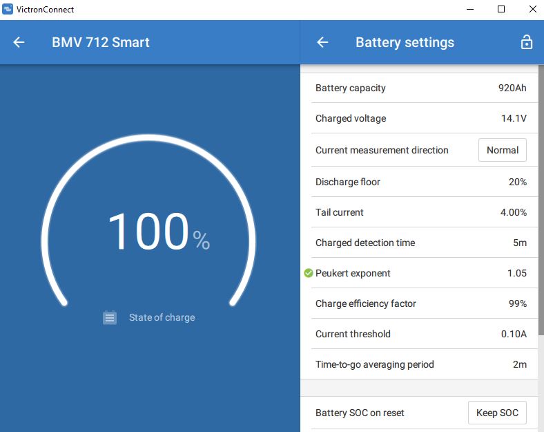

I’m trying to understand why SOC would reset to 100% when the criteria isn’t met. This is a 920ah LifePO4 bank charged to 14.2v. While still charging in excess of 60 amps, voltage at 13.5 I see the BMV reset to 100%. When I start the charge if I’ve pulled 300a out once it has counted 300a in the SOC automatically goes to 100% regardless of the current, voltage, etc. The charging is still in bulk mode, hasn’t even entered absorption.
4% tail current would be 36.8a but it’s always way higher when it sets to 100%
See attached screen capture of battery monitor settings.
Your settings look fine.
If it has started at 100%, pulled out 300Ah and recharged 300Ah then of course it will read 100% again, this is how it works, by counting energy in and out. The synchronisation settings are to make it go to 100% if the battery gets full when it is displaying say 90%. You need to ignore the SOC for the moment and carry out a full charge right through absorption to float then the 100% will be correct. Batteries often arrive at 40-50% so the initial SOC is wrong. You need that absolutely full charge to float to get everything aligned.

Thanks for the response. I’ve had many cycles to 100%, manually forced synchronization at 100% again (after battery stops accepting current) and performed a zero current calibration. The wiring is correct, all negative loads come off a bus bar and the load side of the shunt connects to the bus bar.
When charging, battery will be at 94% for example and shunt will already be at 100%. It’s like it’s not counting properly on the discharge. The gap is closer when cycling down to say 40% in one day and charging back up to 100% but if they sit at 60% charged on lower float voltage for a week the gap gets larger and larger. In the 300a current case, 350-360 actually went into battery but shunt was 100% at 300a.
Thinking to try raising peukert up to 1.06 or 1.07 and see.
The other.one is reducing the charge efficiency so it does not count up.as fast.
