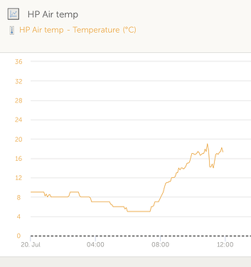

The next release (currently in beta) will allow any sensor (could be a ruuvi etc) to be configured as a virtual temperature sensor which appears on VRM.
In my use case I am pulling temp information from a smart device, over wifi and then using vrm to report and chart the data.
