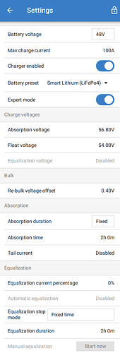

I am attaching a screenshot of the information from Victron Connect with the default values for absorption and float. I remember that during the system configuration, the installer manually entered the battery bank data, with the respective capacities, voltages, etc.
