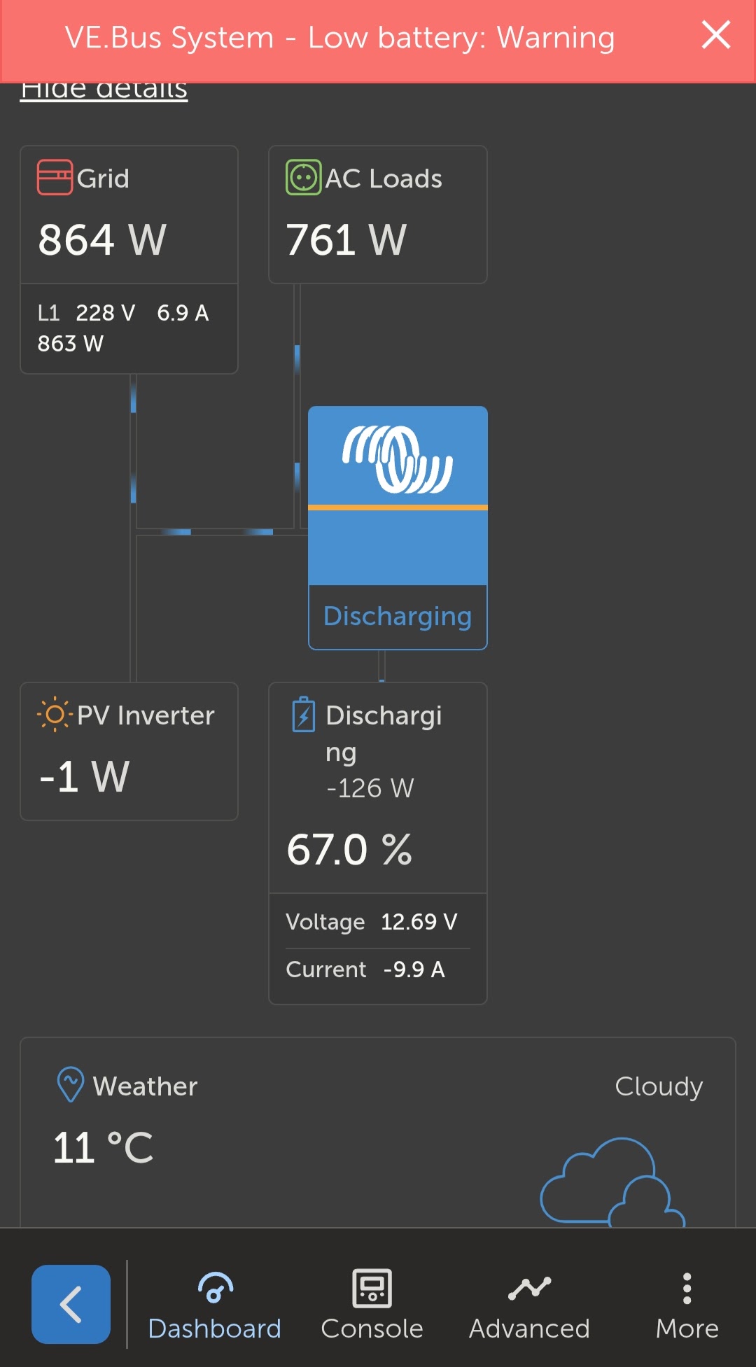

MY ISSUE - As we head into Autumn in the UK, I’ve noticed that my batteries are draining during the evening as lights are switched on but only to 68-70% after which the inverter then starts charging them up 1% or 2%, then they discharge 1% or 2%, then charge again, then discharge, generally doing this and sitting at around 68%-70%. Just at the point it stops discharging and starts charging, a message shows saying #4 BMS has deactivated charging. I’ve googled this message but can’t find what is causing it. I have the SOC set at 25% so I’d expect the batteries to drain down to 25% before requiring any recharging. I’ve searched all the settings and cannot find why this behaviour is happening. Any thoughts anyone?

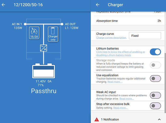

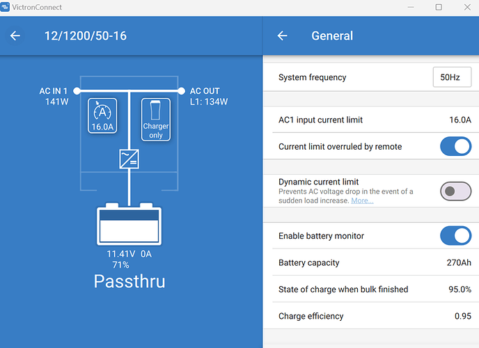

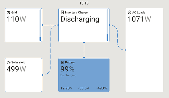

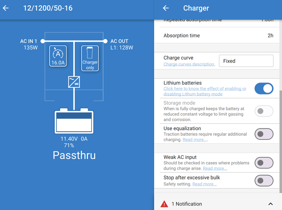

Volts and amps are all alien to me but took some screen shots. First one whilst it was discharging, then the second after it started charging. The third one was whilst it was discharging this morning having fully charged overnight during the cheap tariff. Not a huge difference in voltages being reported.
It would be interesting to see what your battery voltage settings are in the Multiplus, given that you are getting low battery warnings at 13V. Bot the charger settings and the inverter voltage settings - for low volt warning / cut out.
For a 12V system (Sealed or wet?) typically a low voltage warning would not come on until 11.5V.

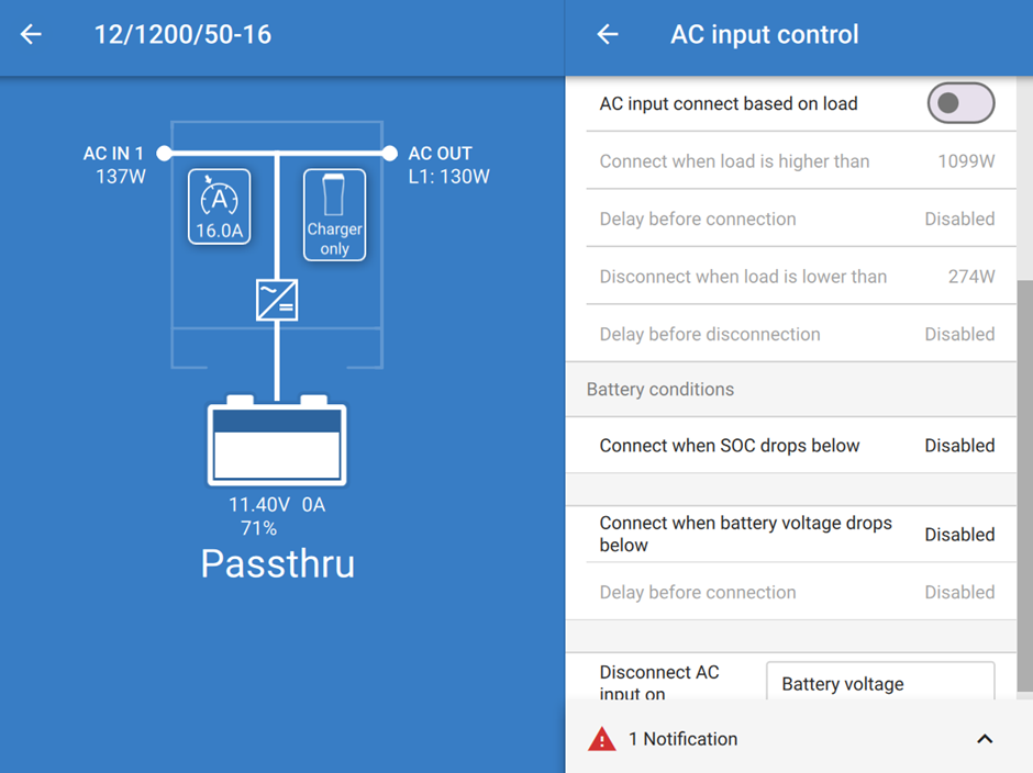

Not sure if I’m showing the right settings but…..

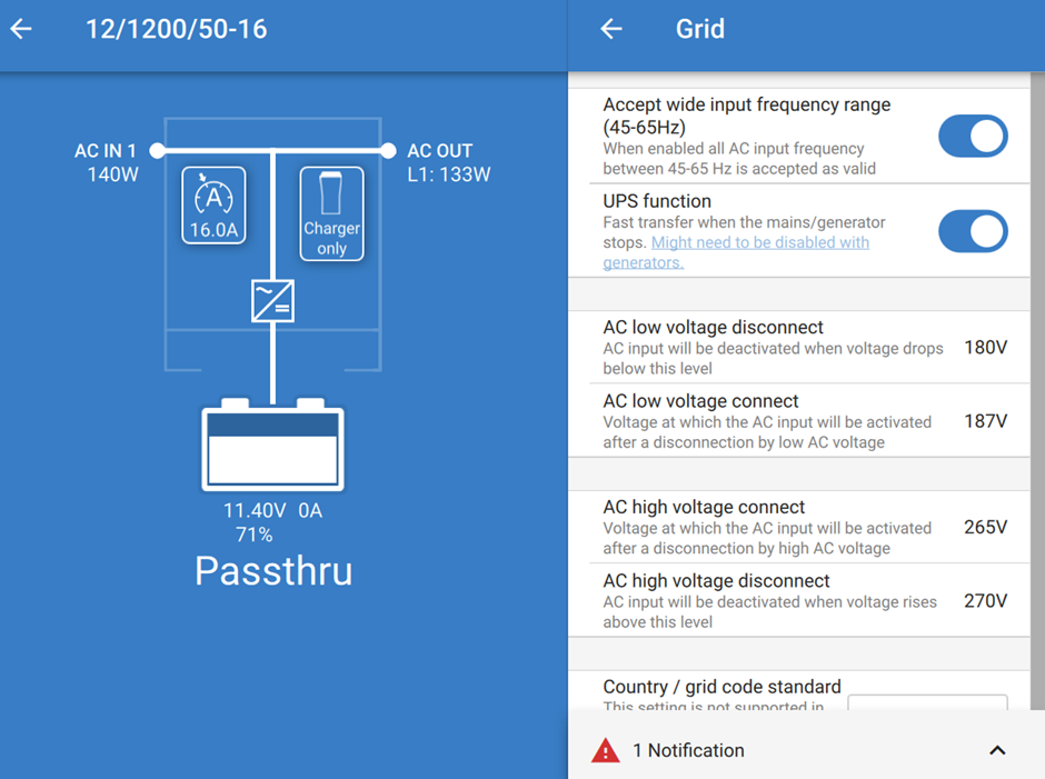

A variety of other screen shots from the system settings……

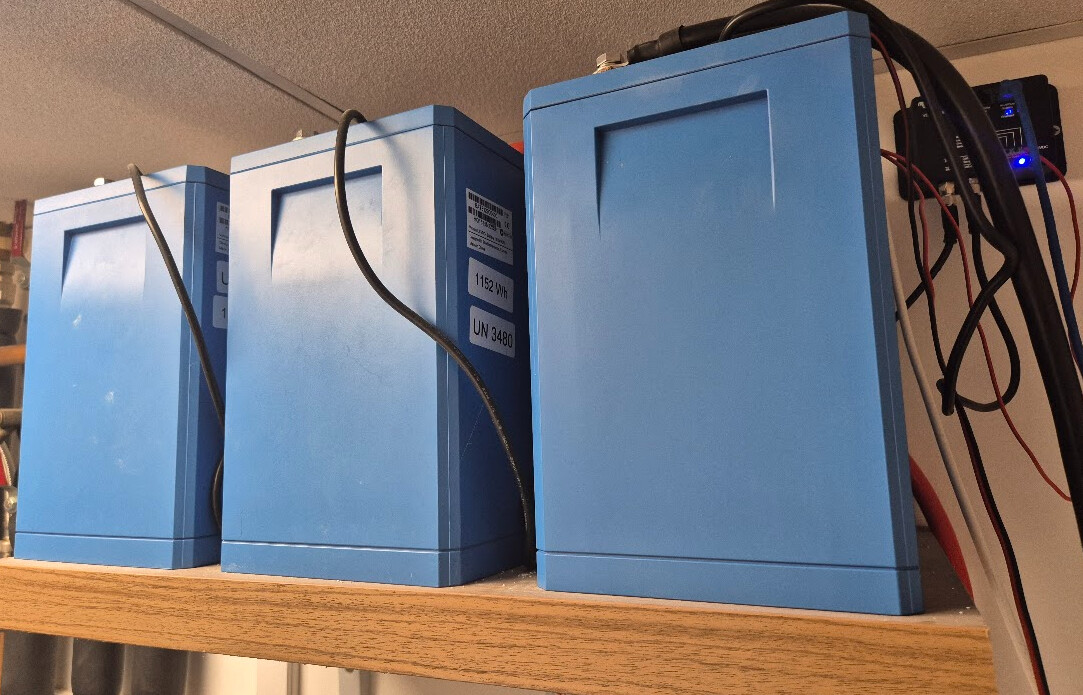

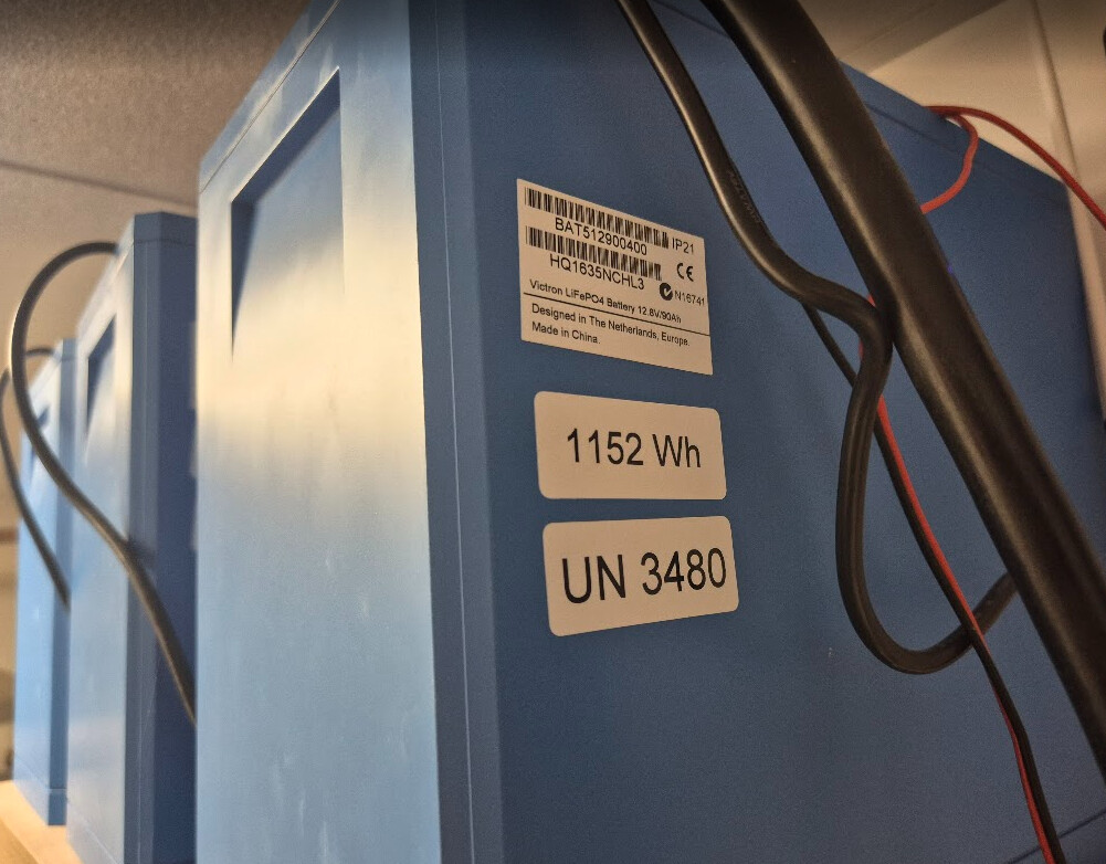

Not sure if my batteries are ‘wet’ or ‘sealed’, assuming the latter but these are them!
Read the label, these are lithium batteries. The Settings you want to get at are in Victron connect. Also look up the battery data sheet to see what the recommended settings are.

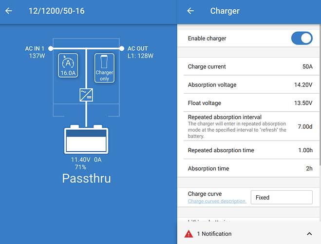

Being the amateur that I am, I didn’t realise that LiFePO4 meant lithium batteries but now know that. I looked up the datasheet and with having 3 batteries, checked the settings including the absorption rate. I’ve put some screen shots below.

Is that Charge Efficiency of yours (0.95%) really part of the datasheet for your batteries? Mine is set to 99%. I wonder what would happen when I set it to something below 1%. Nah. Not going to happen.
Victron Connect suggests the default value of this would be 1 and so not sure its a percentage value, or at least if 1 is the whole number, then 0.95 is 95% of that.
Try setting “ignore AC in”
Your system stops discharging because the battery voltage is just 11.4V. This is the voltage of an empty battery, so the protection is activated to prevent damage from total discharge. What is the voltage when charged to 100%? It should be around 13.8V.
I expect that one of your batteries is damaged.

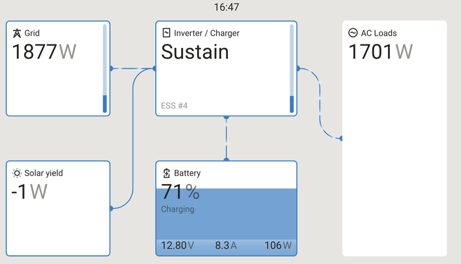

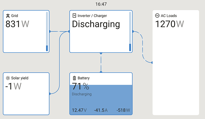

During today, I fully charged the batteries, both with a trickle charger and forcing the inverter to charge batteries. Once they got to 99%, it went into absorption charging and then I put the inverter back to Optimize with Battery Life. Volts were sitting at 14.21v.
Battery then started discharging and so did the volts.
Couple of hours later, battery got down to 71% and volts was sitting at 12.47v
Then moments later, the Inverter started charging the batteries and then discharging and then charging and going round in cycles every few minutes!
It doesn’t like being below 12.3v or 12.4v. And it doesn’t seem to want to hold the volts whilst the battery discharges, deciding to then start it up 1% which boosts the volts and then discharges for 1% till the volts drop too low again.

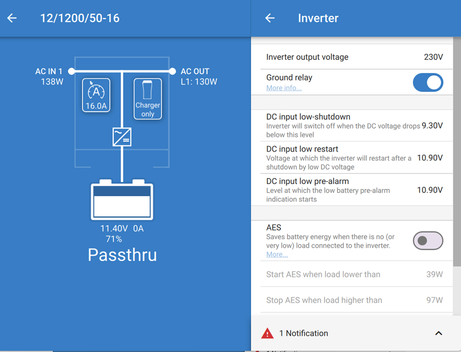

have you changed your inverter battery settings from this:
These voltage settings are for lead not lithium, and should be changed.
I hadn’t changed these, partly because I didn’t realise they were wrong nor can find what the right settings should be. I found what I thought was a datasheet for the batteries I have but couldn’t find these settings. Also confused that they are for lead batteries as if I’ve not changed them, they must be from what the original installer set them too and I’d have hoped they knew what they were doing (unlike me!). That is unless they can reset somehow to a default setting.
I’ll keep searching for what they should be.

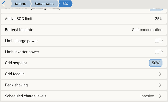

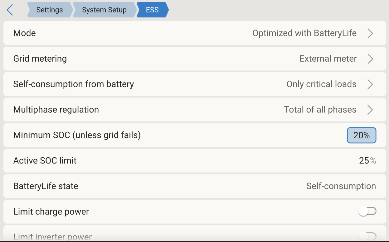

Those settings are overruled in the ESS settings. That’s the reason the discharge stops at 11.4, which is correct for your batteries.
see 6. Controlling depth of discharge
