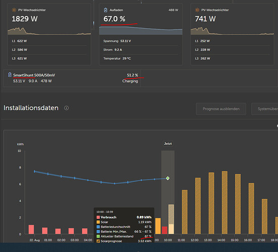

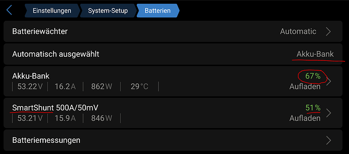

What this refers to is where the battery state of charge is measured. I have installed a shunt, but I don’t use it. In my case, the value comes from the battery’s BMS via the CAN bus. These two values are constantly out of sync.
