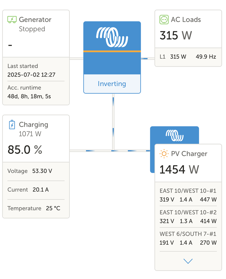

I have a Victron quattro 48V/10KVA set up on a single phase currently off grid with 14KVA Generator which has been running for just over 2 years.
I’m looking to connect a grid connection soon & remove the generator due to the load demands on my home.
The Set up:
1 x Victron Quattro 48V/10KVA/140-2x100 - VW. Bus connection (Firmware - 2653481)
2 x Victron 450/100 Solar charger configured to 33 x 320 W Solar panels (Direct DC Coupled to Charge battery)
2 x BYD 14.7 KW/Hr Batteries with Battery monitor built in each battery
1 x Cerbo GX (V3.52)
1 x Hyundai single phase 14KVA 11KW real power Generator
