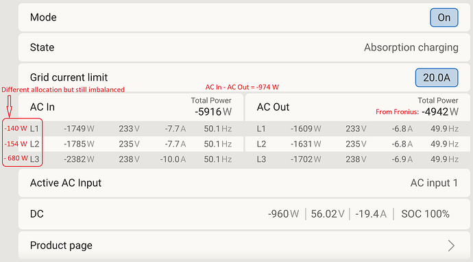

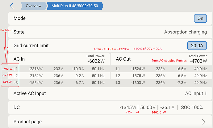

I’ve noticed that the inverters do not share the DC export equally.
I’ve also noticed that if I disable and re-enable DC feed-in, the distribution of power among inverters changes, but it does not equalize. The two attached pictures are taken a few minutes apart, after turning off and on DC feed-in.
Is this power distribution normal?
Curious if changing the regulation mode makes any difference (technically it shouldn’t)?
If you disable the fronius and just use DC exporting how does it look then?
Changing to Individual Phase does not fix the problem but it changes the power distribution.
Turning off the Fronius and keeping just the DC export does not fix the problem and does not change the power distribution.
Sometimes the inverter on L3 is almost idle, sometimes (after changing a setting) the inverter on L3 takes the highest export power share…
