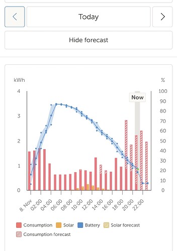

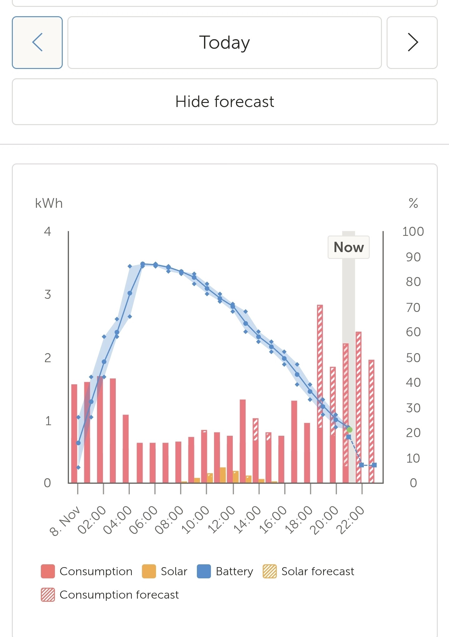

There seems to be something wrong with the consumption forecast for tomorrow 17-18:00. My system hasn’t done much lately since sell prices have been low and all PV goes to consumption. This will change after tomorrow as we transition to 15min buy pricing.

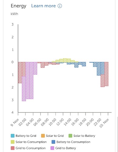

Another interesting forecast for tomorrow, with very low consumption. There must be something wrong with the estimation system?
We never have this low consumption. We always have a base load, at the very very least 300-400 watts at this time of the year. For example, see today (which was a great DESS success by the way!):
