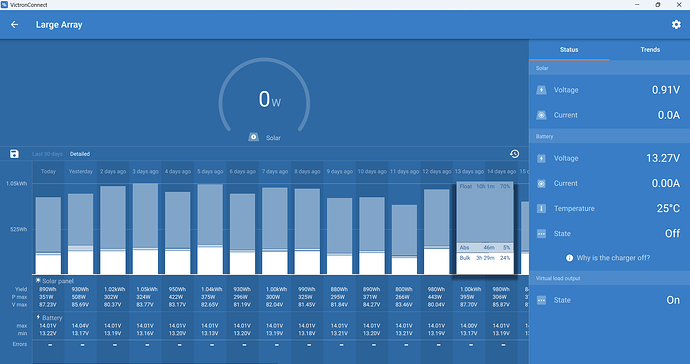

Have a look at the mppt’s history.
An example from my system. Mppt programmed for a 20 min absorp time.
Days with cloud, or loads prompted an extra amount of absorption time.
