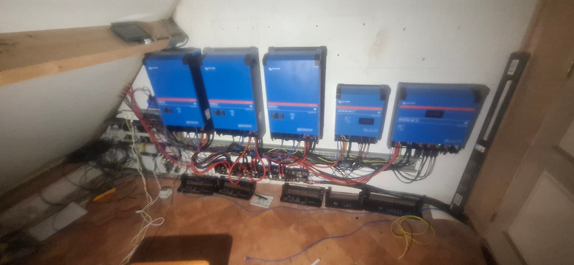

Recently I have installed this system in my old farmhouse :
3x Multiplus II 48/10kVA
1x MPPT 450/100 solar charger
1x MPPT 450/200 solar charger
1x EVCS EV charger
VM 375CT grid meter
1x Cerbo
1x Lynx shunt
3x 45kWh chinese LFP batteries.
And
2 SolarEdge Inverters.
Still in progress

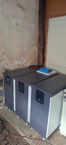

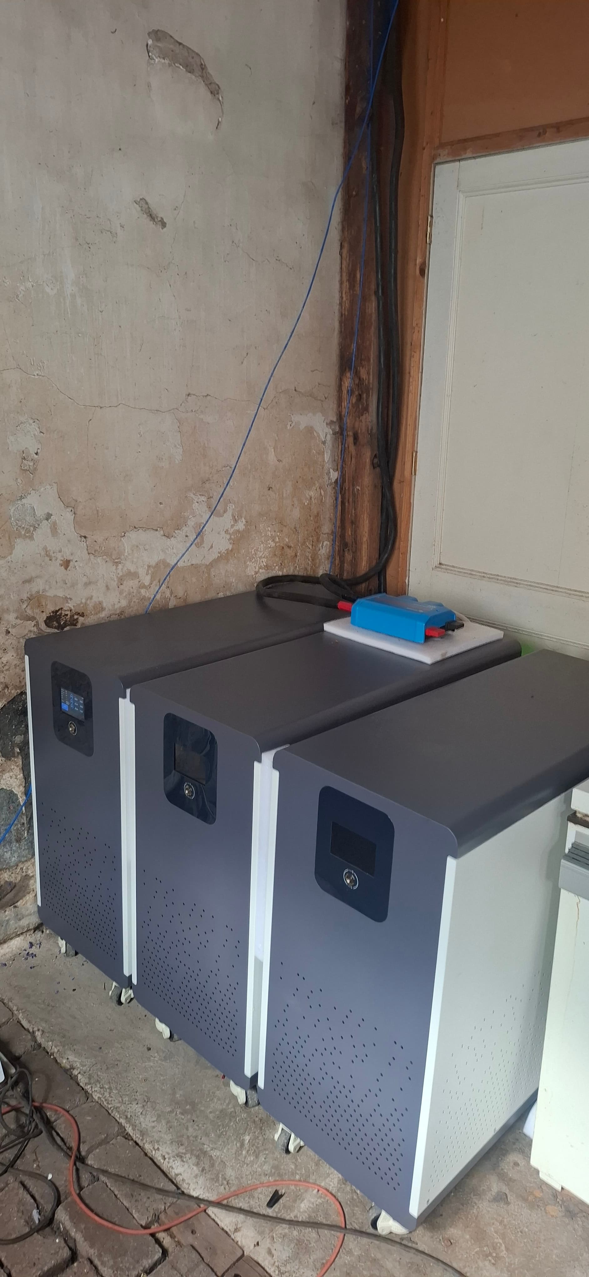

Hi Richard, welcome. Maybe add some photos of your installation. Thanks.
Done, as you can see still in progress…
The battries are 340kg each so they never made it to the first floor, now connected with 150mm2 and a remote voltage sense.

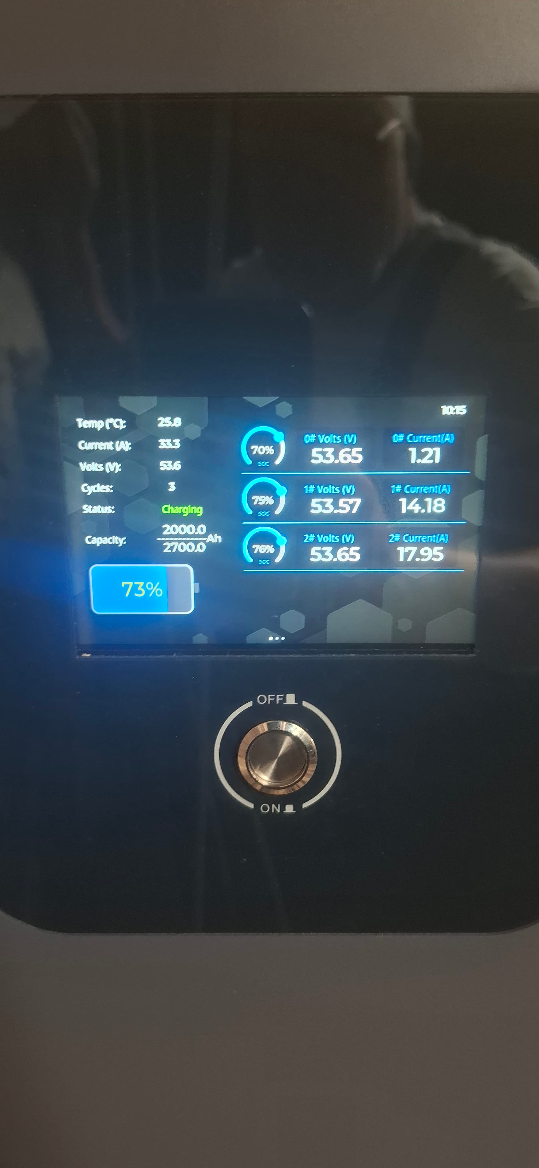

Not allways sure about the slecs of the Cinese products. Hiwever, it has 5A active balancing, heater, bluetoth wifi as addon and 280AH 16s3.
Did not yet get the bms to connect to the cerbo but as I have a linx shunt it is not really important. It has a nice display and I did connect the bms of the three together, so is shows the master.
