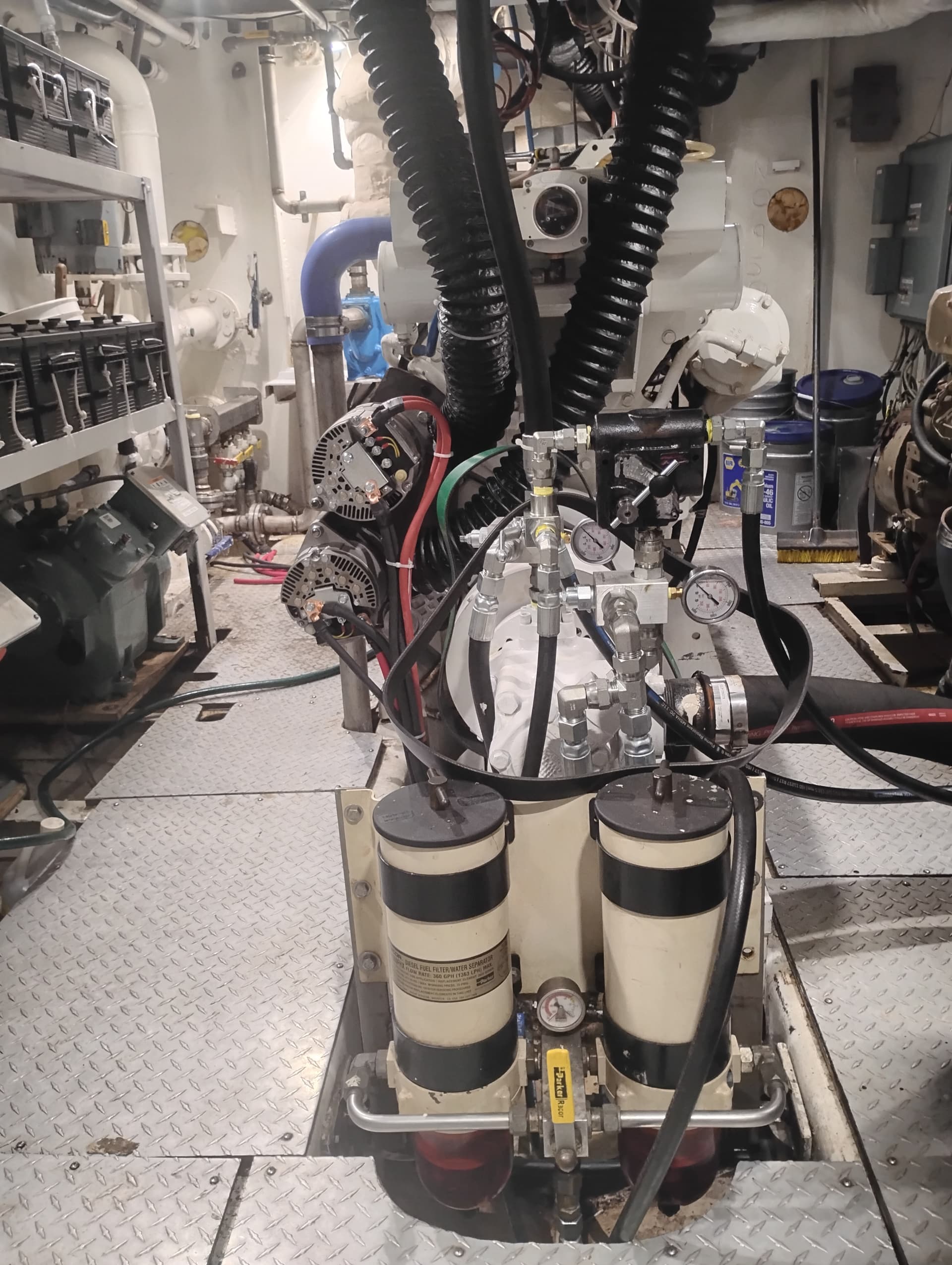

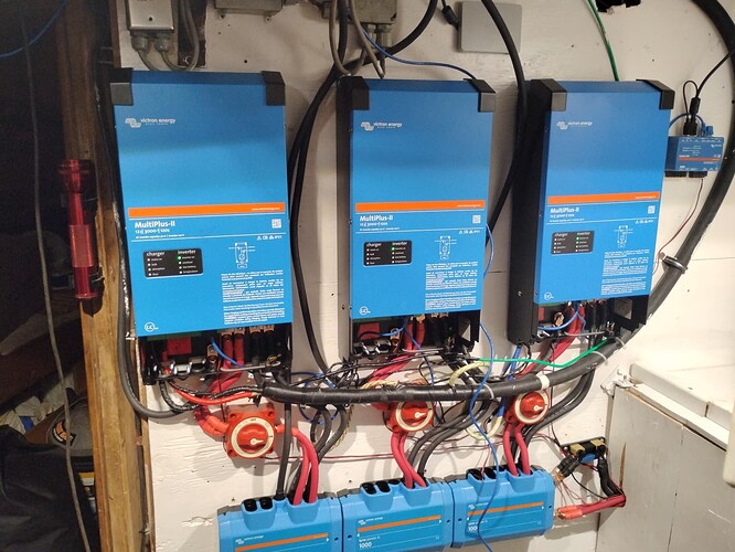

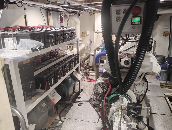

In the course of 3 weeks I taught myself how to built a suitable 3 phase off grid system for a commercial 66ft fishing vessel now that it’s tested and passed flawlessly there is a large window of opportunity in this area opening up. I need to know how to proceed properly, getting licensed and creating a business to help these industries reduce there impact on the environment by reducing there requirement of fuel consumption.

Hi sorry for my comment, but if tou want to make a business out of it you really have to clean up the wiring! :blush:
uh so I will be the dick
you should NOT do this for hire, at least not yet, you have no idea how much you don’t know.
if I’m not mistaken those are Lynx power in units feeding the multis, start with learning why that is bad.
don’t even know where to start with the AC wiring.
you have a lot to learn, and would not want to be your insurance underwriter.

Wow I appreciate the honesty and words of advise. Never having heard of victron before 6 weeks ago and having had the equipment purchased by someone who has little knowledge or experience with it either I myself am surprised the system continues to operate so well. I’m currently completing the professional courses with victron. I am willing to go to college for electrical engineering as well as an apprenticeship. Wanting these systems to be configured properly and installed with precision. I’ll do as suggested and continue my training and find a professional in my region to lead the way on this venture until I am capable of completion myself I’m sure I will need more than one crew in more than one nation before it’s said and done.
