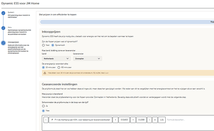

Zonneplan in the Netherlands uses a Solar bonus between sunrise and sunset of 10 percent.
The flow I created in nodered adjusts the dess scheduled sell formula according tus sunrise and sunset every day at 1:00.
