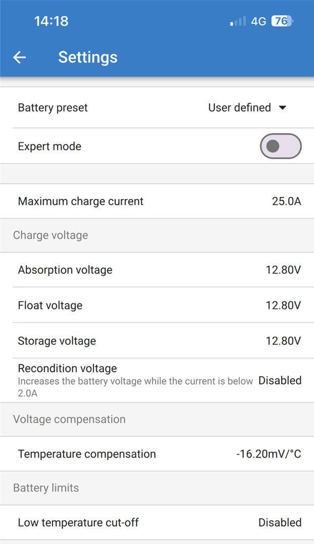

Will the charger respect a maximum charge voltage?
The Phoenix Smart 50A (1+1) does not appear to respect the charge voltages.

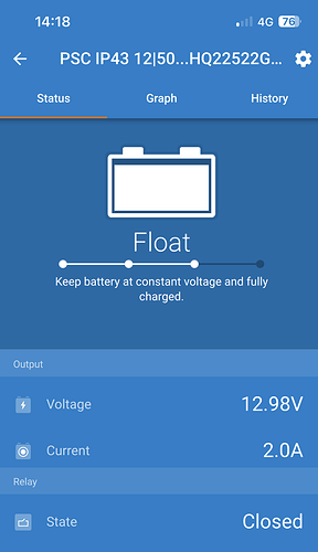

For example, if I set the charger to a maximum of 12.8V:
When I connect a battery > 12.80V, I would expect no charging! Yet the battery is charging….
This makes me very nervous, that when I change to a LiFe battery, the charger may ‘do as it wishes’ and overcharge the battery….
Any thoughts? Thank you…
You have temperature compensation enabled.

Hi… Thank you! Yep, that solved my issue - and I had not picked up it was off when using a lithium preset…
