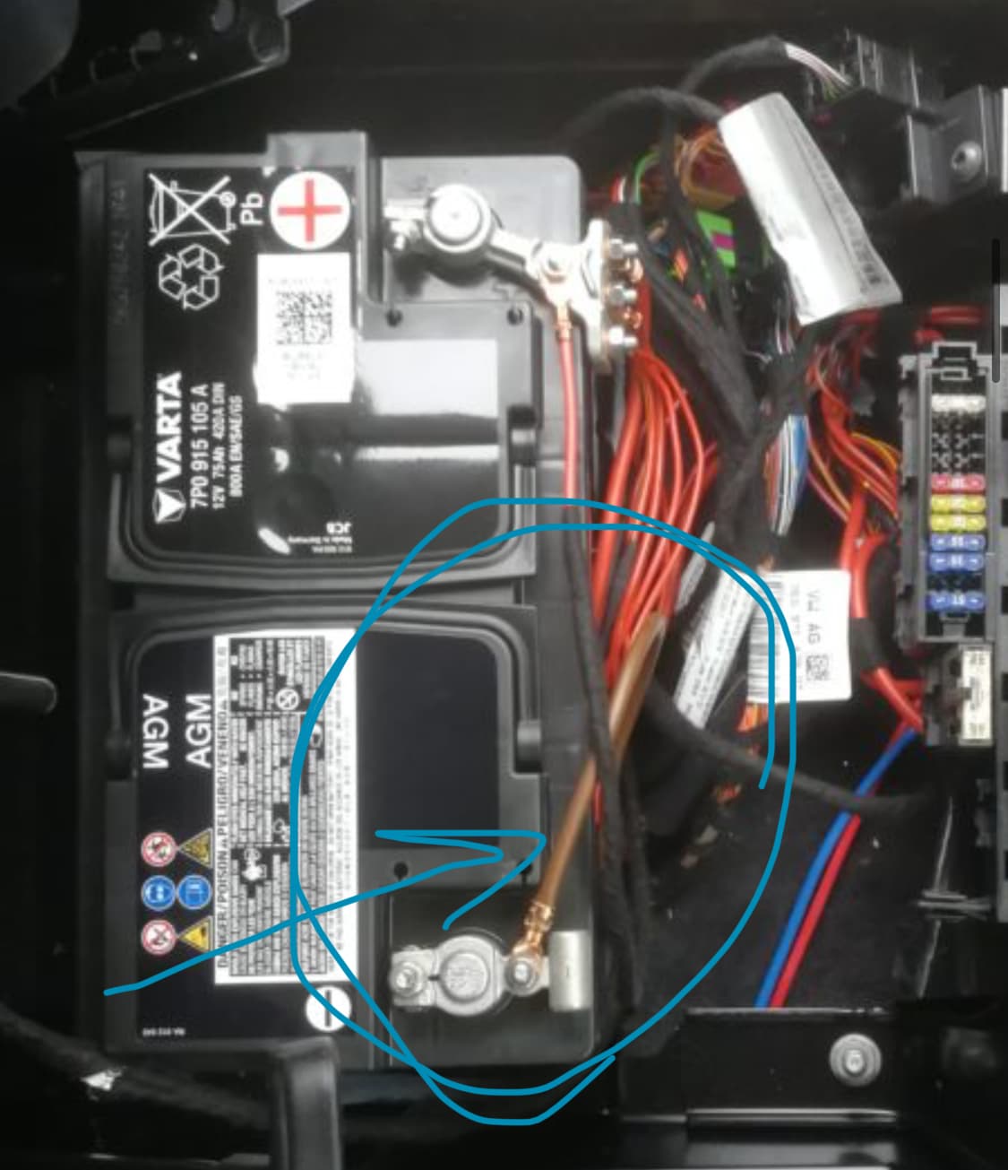

Hi again,
ok, so had a closer look at the mass cable for the second battery… do you think this can handle even 300A?
I measured it… should be a 6mm2…
So maybe the 300A should be enough?!
Im sure it could handle 300A but the question is, for how long :grinning_face_with_smiling_eyes:
So yeah, the 300A shunt is sufficient
