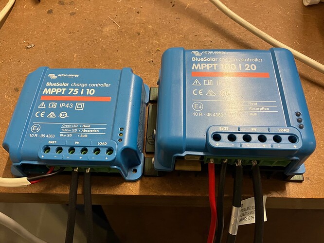

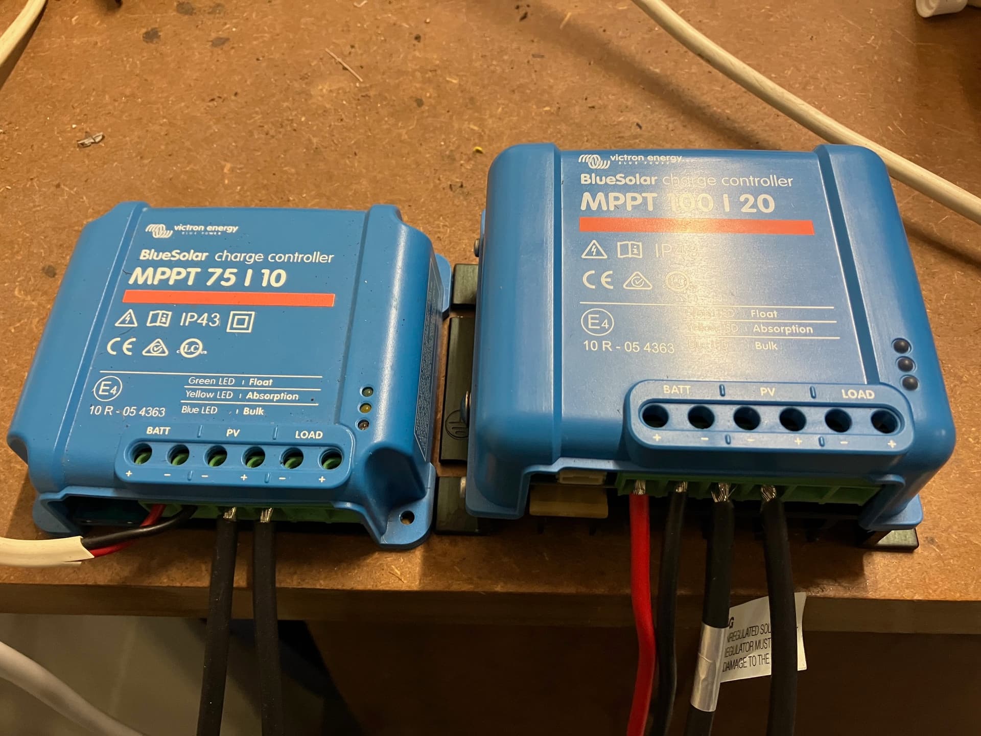

Dimensions are readily available, but here is what they look like. The 100/20 is a little more chonky but the same footprint.
Thank you for your time taking these photos. Yes that what i was talking about with the heatsink but since it will work “better” than the other i think i ll go for the 100/20. I would like to take the 75/15 but its to close to the maximums and i dont want any problem to occur.
