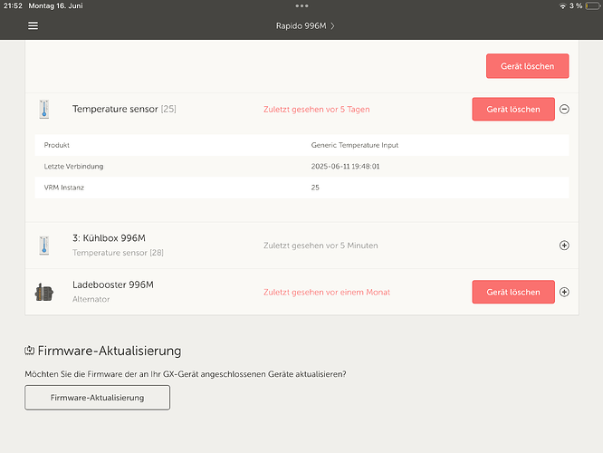

Hello everyone,
A temperature sensor has just appeared in the VRM portal that I’ve never seen before. The portal supposedly last saw it 5 days ago.
All my Ruuvi Tags are still showing, and my SmartShunt is also displaying the current temperature, so I assume that the sensor connected here is working too.
Do you have any idea where there might be another temperature sensor connected as a device?
Many thanks and best wishes
Michael

Thank you very much for the tip. I’ve just checked in the RemoteConsole and couldn’t find any activation.

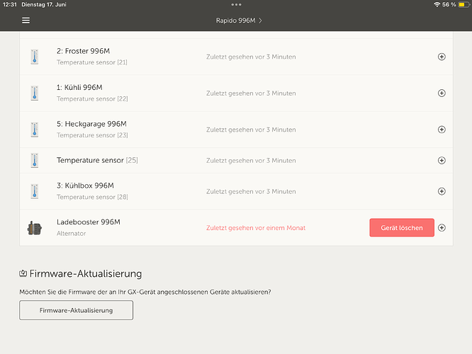

I then checked Devices in the VRM Portal, and now it seems that the system has detected the temperature sensor again. I still don’t know what it’s supposed to be, though.

I’ve just tried it… if you briefly activate the temperature sensor once and then deactivate it again, it remains listed in the device list as not connected.
You can try selecting “Remove disconnected devices” at the very bottom of the device list in the Remote Console…..

PS: And now it’s gone again :wink:
hello,
temperature sensor 25 is normally the first temperature sensor on the Cerbo. however, it could also be another device, as the numbering is not fixed 100%.
goodbye
I thought that too at first; for me, 25 is the second entry. The first one is 24.
