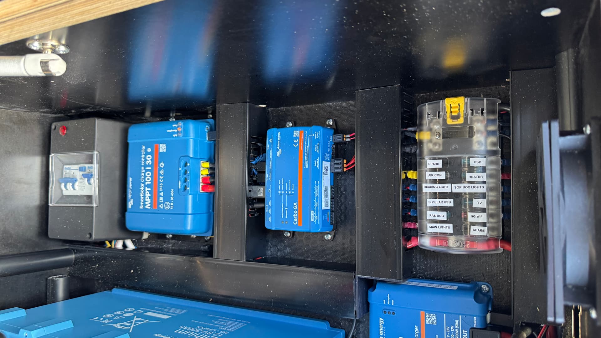

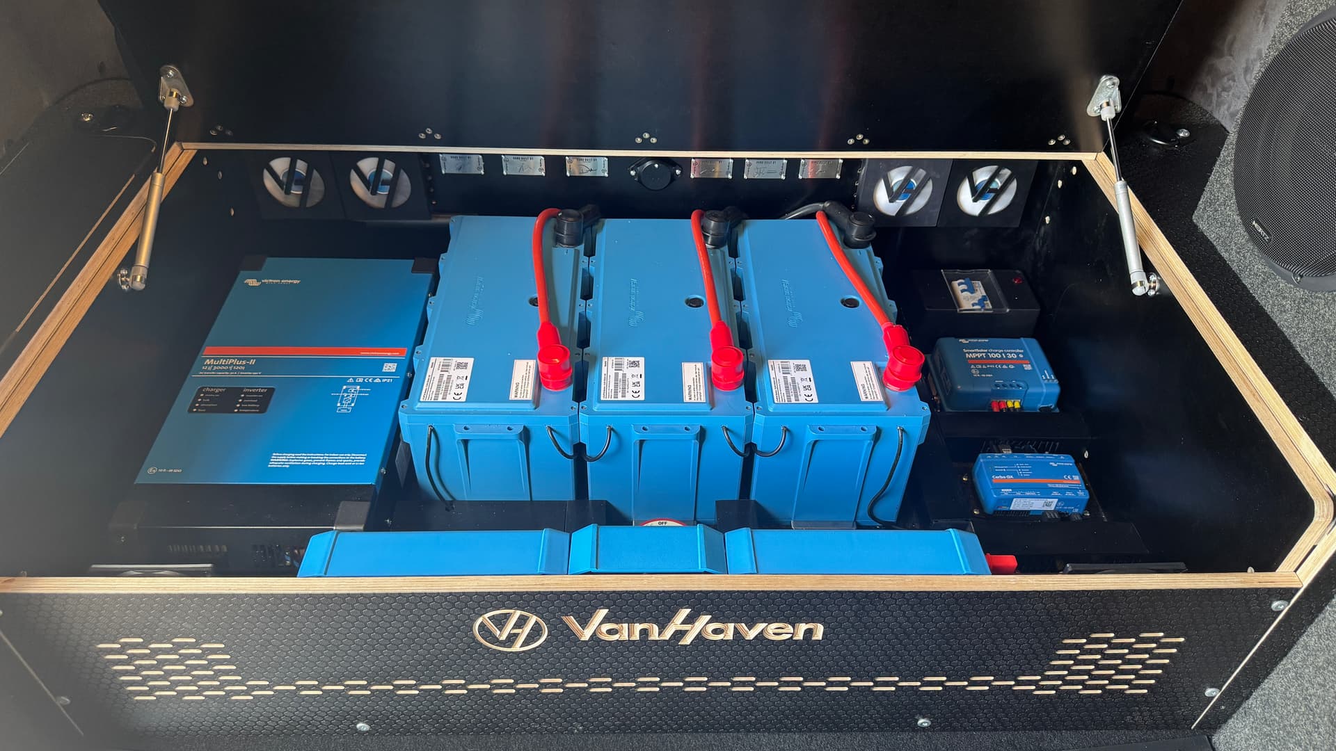

So I have the following installed in my van so I can go off grid for 3-4 days and run all the creature comforts, including a world first of an Ebersacher 12v externally mounted air conditioning system, 24" TV, Apple TV, WiFi lights, fridge etc.
Cerbo GX MK2
GX Touch 70 Flush
MultiPlus-II 12/3000/120-32 230V

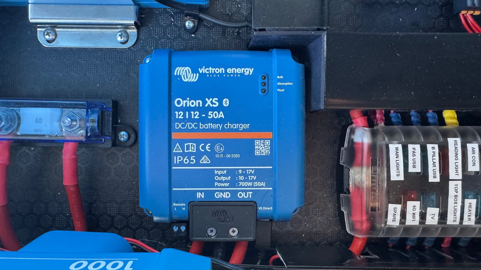

Orion XS 12/12-50A DC-DC Battery Charge
SmartSolar MPPT 100/30
Lynx Smart BMS 500 NG (M10)
Smart BatteryProtect 12/24V-100A
Lynx Distributor (M10) x 2
LiFePO4 Battery 12,8V/300Ah NG x 3
270w solar panel
Very clean, well done :smiley:
Clean install. Good job!
Is there a particular reason to not mount the battery switch in such a way that is easily accessible ?
It looks great, especially the box.
would be nice, to see some wide angle fotos.
But what is the purpose for Your project?
What is the demand for so much energy in a VW Transporter?

Hi.
We have a world first externally Eberspacher 12v aircon system that is amounted under the van and vented round the underside perimeter of the pop top
We want to be able to go off grid for 4 days using aircon, WiFi, tv and all charging etc without EHU
