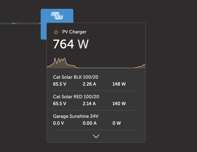

title says it all, I have 4 different chargers, and one feeds the backup battery, which is only being charged when the main batteries are full, so it mostly shows 0W, but it takes place 3 in the list, and the fourth is only visible with an extra mouse click (usually hidden)
so how do I get the 4th to be 3rd in the list and the current 3rd to be last in the list? is there a way?
TLDR: how do I change the order of the solar chargers in the vrm dasboard?
I have just tried it out with my 3 MPPTs:
The sequence changes depending on the “font” in the alphabetical order.
Why he now sorts your “Garage” before the “Cat” is quite strange.
