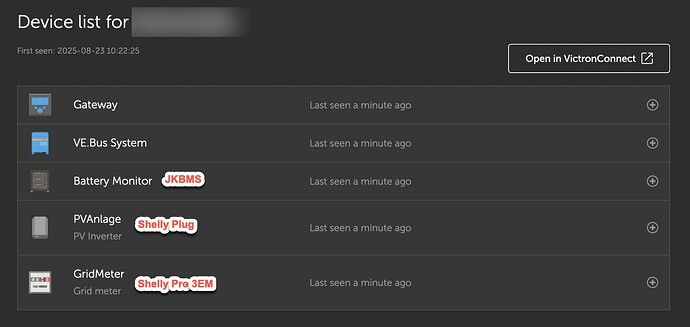

Both PV and Grid meters are shelly meters (PV = Shelly Plug and Grid = Shelly Pro 3EM). I tried web socket integration and dbus-shellyPlug integration for the Shelly Pro 3EM but this does not change anything regarding my problem. Changing the energy meter is not option as I have no way to get a wired connection to my energy meter and this being a refresh problem make no sense as compensation (which would be more timing sensitive is working perfectly).

Involved devices:

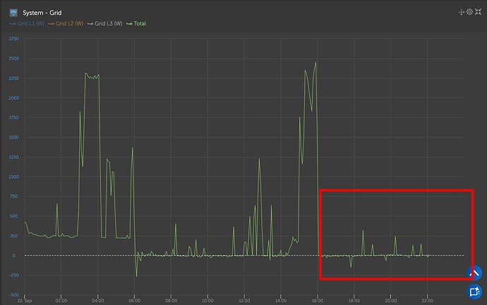

Grid sum is shown correctly too:

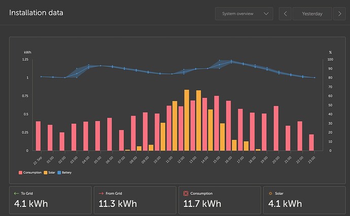

If I take a look at yesterdays consumption.. I see 11.3 kWh from grid, 11.7 kWh consumed and 4.1 kWh to grid… So I would have to manually calculate which would mean 11.3-4.1=7.2 … If I take a look at my providers report for yesterday I see 7.998 kWh .. this could be good enough with <10% of deviation … I will monitor it for some days.

In comparison my grid view:

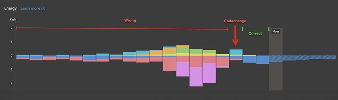

Here how it looks now.
After one day of monitoring the changes indeed worked.
Prior to the changes DESS was working great as all 3 phases were balancing perfectly, but all reports were completely off as all negative phases were treated as “sent to grid” and compensated phases were treated as “from grid” … which simply is wrong from a price point here in Austria.
Example of wrong report:
Example of now correct report:
