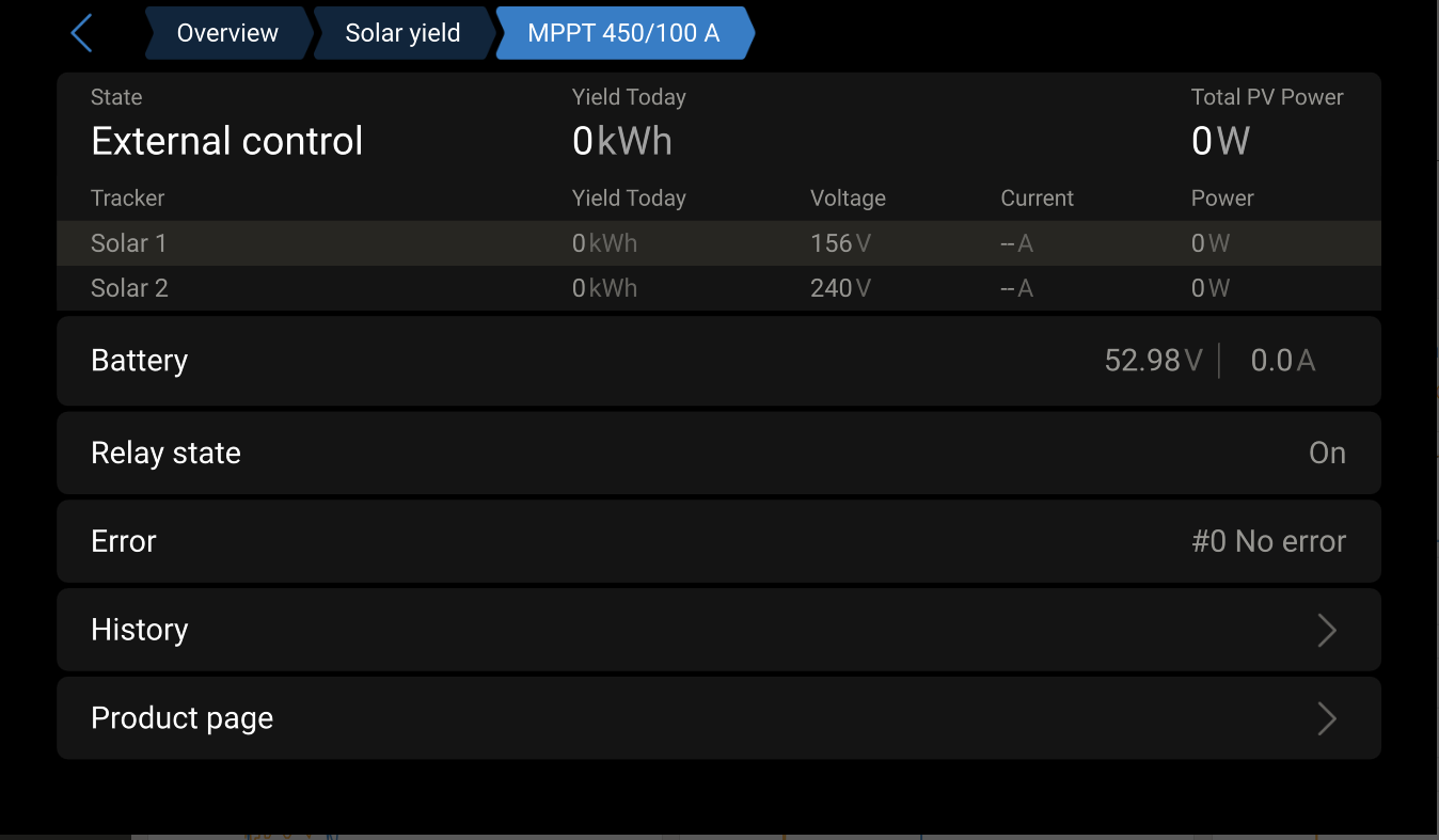

This morning the solar MPPT’s stopped at all, sun is fully shining
Looking at voltage of MPPT’s should start producing
I rebooted Cerbo and MPPT’s several times, no error shown in MPPT devices
I downgraded from beta to official large firmware on the cerbo, and the MPPT’s are up again
In VRM is the solar tab also visible again, seems the problem was with the beta cerbo firmware
