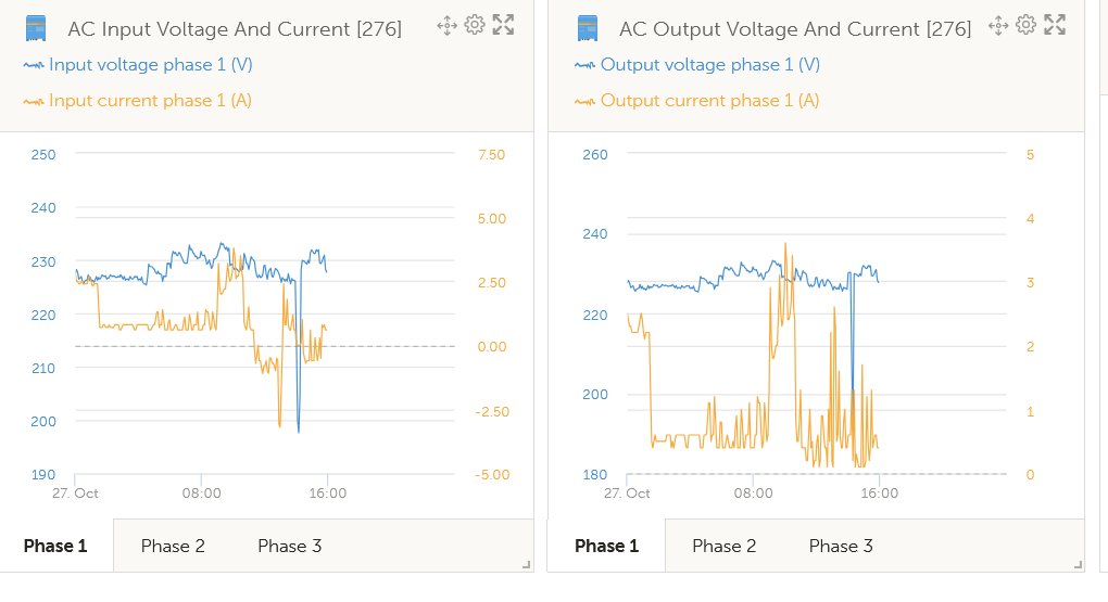

On some occations I get the alarm that connection to the grid is lost or there is a problem with phase rotation. The connection to the grid is usually not restored until I restart the Multiplus. After those occasion it happens often that I have somewhere a dead heating pump or a dead usb-charger or something similar. Today it happened again. I looked the voltage history up and noticed that there has been a very low voltage on all the output phases (190V). On the input side from the grid(AC input Voltage) 2 phases had the same low voltage and von phase had a very high voltage (315V).

Yes it is a serious problem. But since I don’t find a electrician willing or able to do this I want to research myself and than look after somebody certified willing to do the necessary work. Here are screenshots of what happend according to the dashbord. I have only the grid on ACin. I have three Multiplus II for the three phases.
