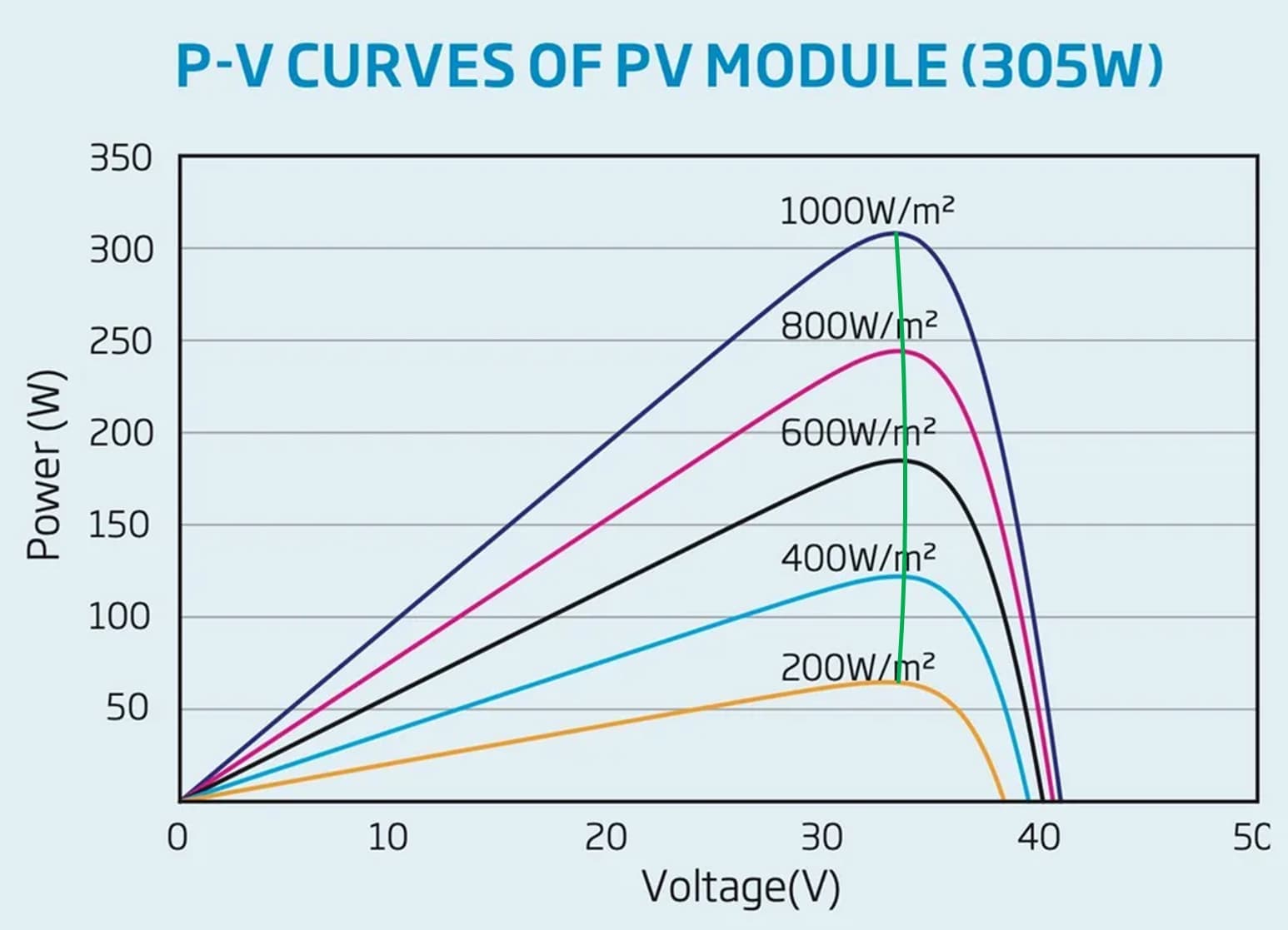

Here is a plot of voltage vs power for various light levels for a panel about half the voltage of yours. Open circuit is 42V but the peak power voltage is about 34V, which is in line with your drop. Then if the light level varies, the peak power voltage does not vary much, but the current will. Hopefully this is useful to visualise the operation. The voltage has to fall below the open circuit voltage to provide the voltage difference to develop the current flow through the cells.
