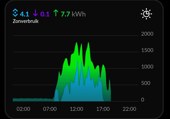

Because of this, 7 kWh was fed back into the grid while the battery is not fully charged.
I have never seen this behavior before. On L3, at certain moments, it showed more than 1100 W while nothing was connected. Could there be something wrong with the calculation of phase 3?

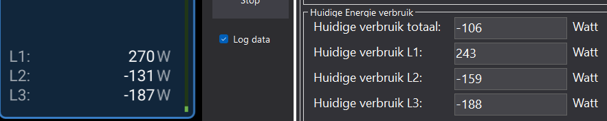

I did a check to compare the Fase 3 value of the home wizard and victron
The VM-3P75CT HQ2419A7WHP is not messuring the correct value any more of fase 3

I checked the clamps. They were all clicked into place, but I still had the feeling that they weren’t closed properly. To be on the safe side, I put cable ties around the clamps to make sure they were closed properly.
The measurement deviation of phase 3 was still present. It seemed to be slightly smaller, but it was still not being measured correctly.
For now i will run the ESS only on the inverter/charge meter.
After installing the cable ties, the difference was much smaller. That’s why I did another measurement, and now the difference seems minimal. I’ve now put the ESS back on the VM meter, and in Home Wizard, the energy is fluctuating around 0 again. Perhaps the clamps weren’t tight enough and firmware version 1.10 helped. Now I’ll wait a few days to see if it continues to work properly. In any case, it’s nice that I can always fall back on the meter of the inverter/charger.
Everything has been working fine for a few days now. The ESS is keeping everything at zero to the mains. The cable tie and the firmware seem to have solved the problem. I will keep an eye on it.
