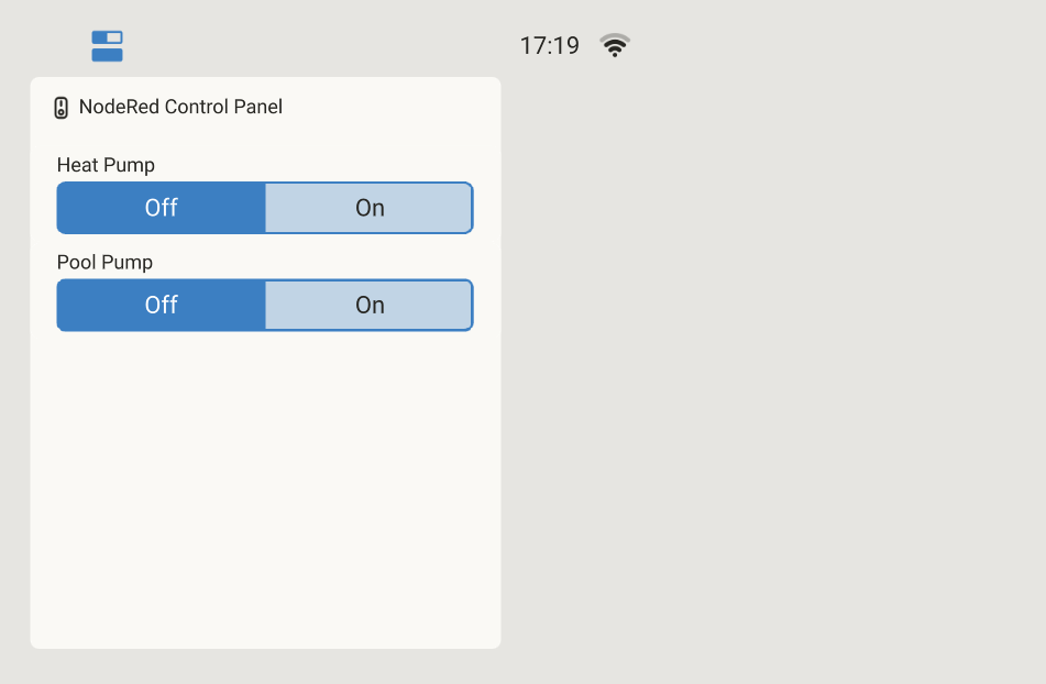

Try the beta, You can use virtual switches, which will appear in a new nodered dash on the new gui.

Mine are only on the dashboard and I’d like them on the Console.
