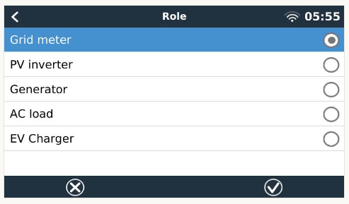

I am using virtual grid meters in Node-RED to graph external loads in VRM. Unfortunately it is not currently possible to assign a role to virtual grid meters, like you can do for physical meters:
Being unable to select “AC load” as the role of the virtual grid meter means that Venus OS will switch to using the virtual grid meter as the source of the AC input power reading when the actual physical meter disconnects temporarily. The latter can happen, for example, when a user clicks on Device List → Firmware Update in VRM to check if there are any available firmware updates. When Venus OS has switched to using the virtual grid meter as the AC input power meter it will continue doing so until the next reboot.
