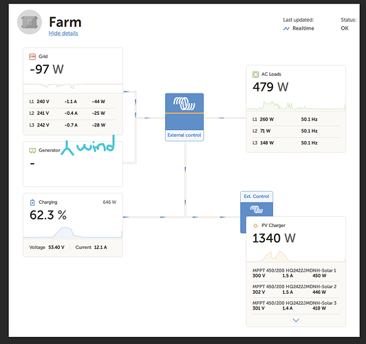

hi
im looking to add an AC wind turbine (not dc). just feed it directly into the grid skipping the batteries for the sake of simpleness. however it would be nice if i could get the power data show up in the VRM. how can i do that? i have multiplus 2 gx, enabling ac input2 of course doesnt work i get a blank box cause it has no ac input 2 right?
can i use the victron ac current power meter and wire that into multiplus? or the ET112?
ideally if i could feed data in myself that would be best, i have enabled root on the cerbo and have no problem running dbus commands or writing data to logs, but i dont know where i would have to send the data.
currently i made my own DESS on the cerbo with scripts so im reading lots of data on there and manipulating the grid set points all the time based on solar/price conditions in my area.
thanks!
