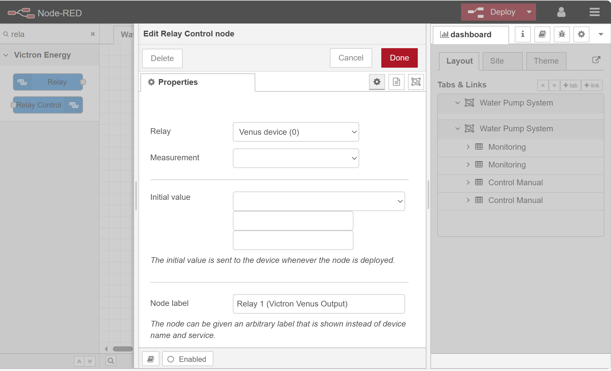

I am able to activate and deactivate the relays from the venus os interface and using also the victron relay node types but when I ask Gitbub Copilot to create the flow, relay node types are not populated well. The measurement property is missing. I instruct GH Copilo to fill up the property but the right content as appears in the NodeRed gui but when the flow is imported, the measurement property stays empty. If you try to edit the node to fill up de measurement field, no options are available to select.
Does anybody know why?
