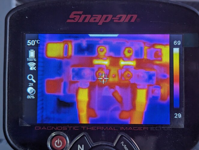

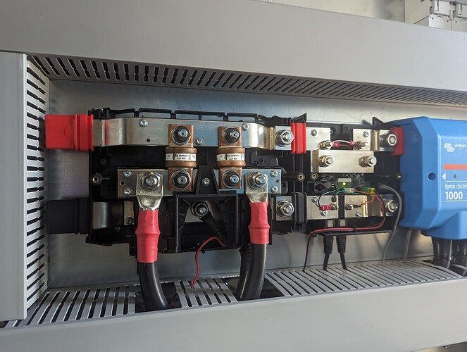

Have experienced some heat generation from the Lynx Class T power in under a continuous 450A discharge load; approx 225A per input. 120mm2 Battery cables.

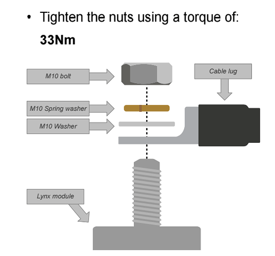

Littlefuse JLLN 400A 125Vdc Class T fuses fitted and all torqued to 33Nm.
Unlike the other Lynx products, the class T enclosure cover is well ventilated, so don’t foresee any issues. Max temperature approx. 70deg (Ambient about 25Deg) at this load, the fuses.
