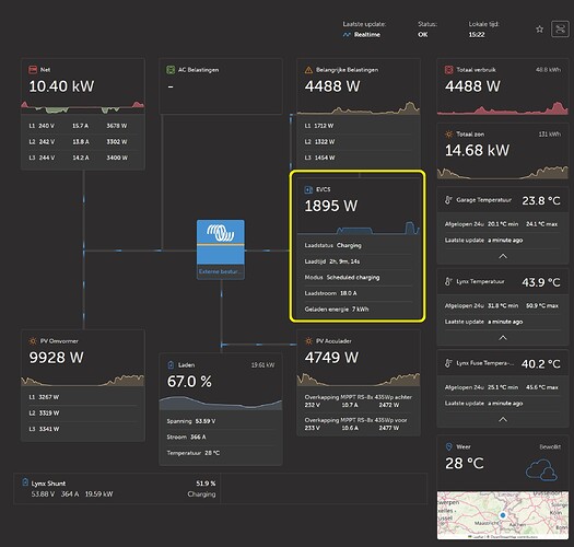

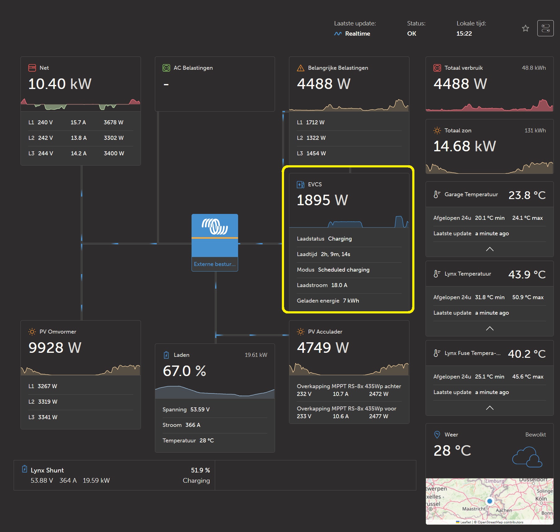

So I was checking the power consumption of the Victron EV Charger NS on my remote console (and also on Victron VRM) and I noticed that the power seemed to be much higher than actual.

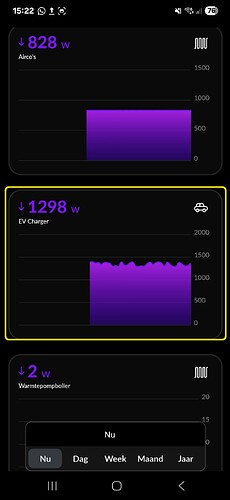

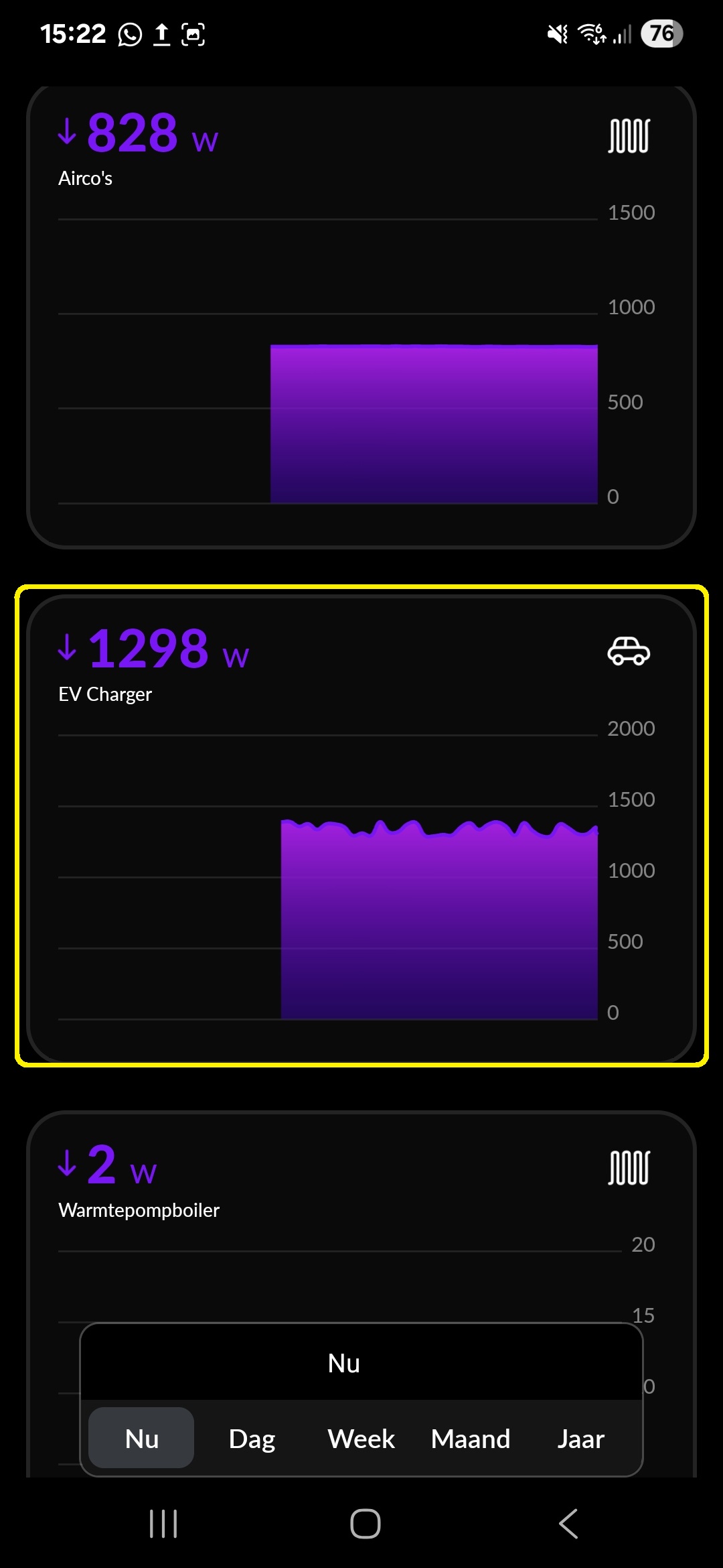

Therefore I installed a HomeWizard 3-phase kWh meter between the Victron EV Charger and the breaker. When checking the difference between the HomeWizard meter and the Victron Charger, I noticed quite a big difference:
As you can see in the screenshots (which were made exactly at the same moment), the Victron EV Charger shows a power consumption of 1895W, while the HomeWizard meter shows only 1298W.
I am pretty sure the HomeWizard meter is showing the correct value.
Anyone else had this issue?
