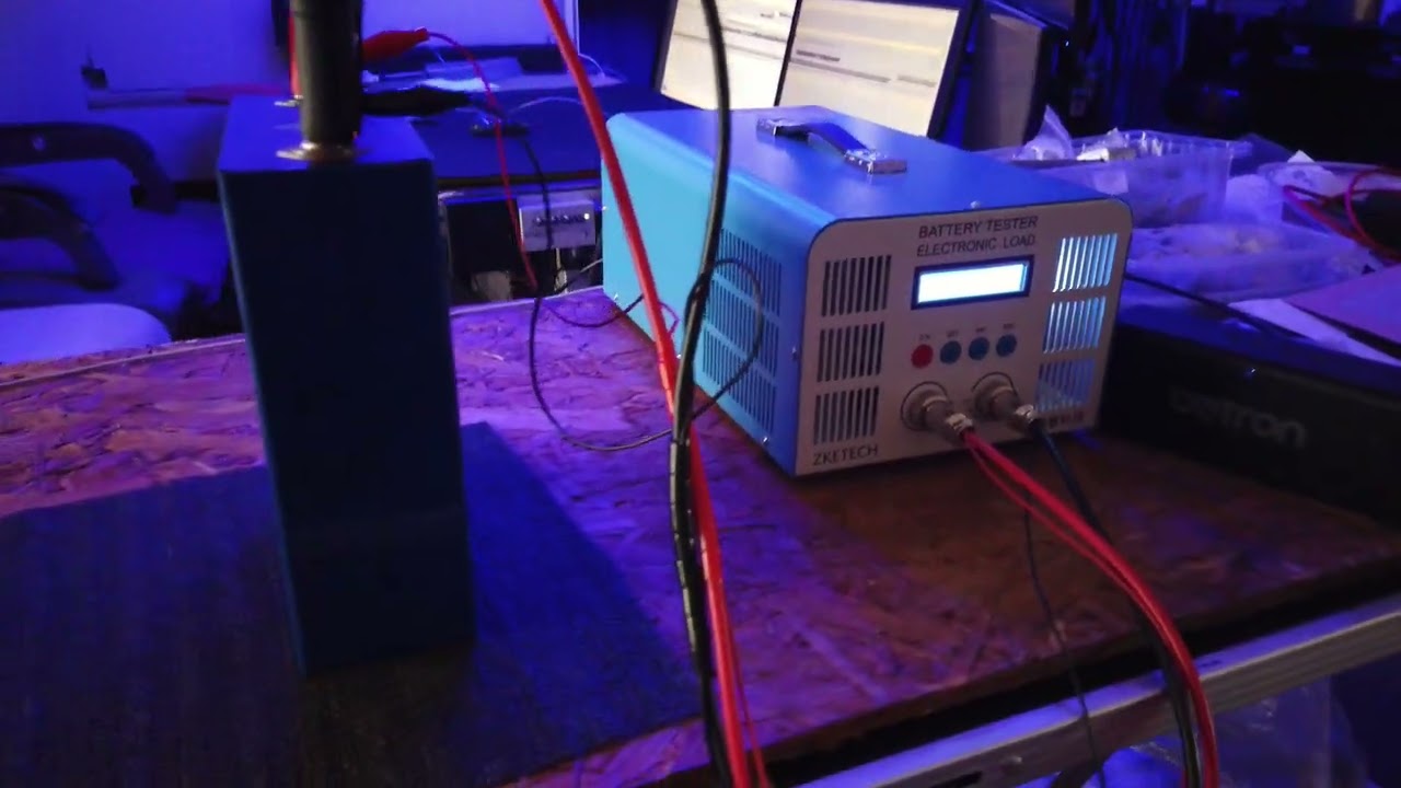

Did you test them individually for full capacity and discharge before commissioning the assembled battery?
This is what I do to my cells as soon as they arrive.
I also had charging problems with 6 out of 32 cells; they slow down the charging process when they reach 3.34V as opposed to the others becoming unbalanced.
Having taken the data during the initial test will enable me to test them again, as soon as the replacement arrives, and compare the current reading with the previous ones, and if I find that there was a rapid degradation, I shall ask for a replacement
