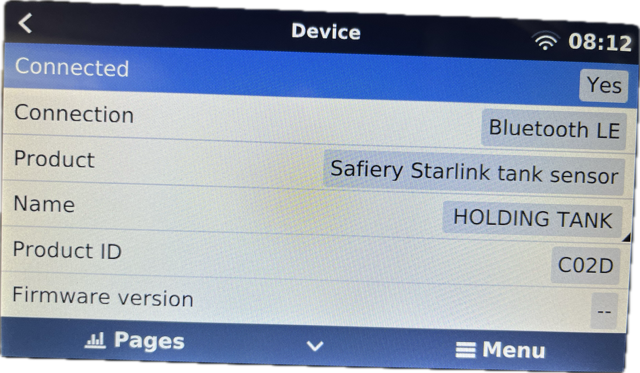

Hi what kind of sensor are you using?

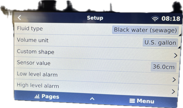

And can you share sone screenshots of the settings?
Matthias
Safiery Star Tank sensor. Screenshots shots attached. I have not yet configured the Custom Shape. Thanks
