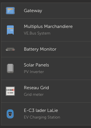

Well, having three different rs485 to usb cables and different id’s it makes it quite clear. Strange is only the one configured as gridmeter shows up in the energymeter menu. The one configured as solar is not showing up in the list but! shows up on the device list. Maybe because its configured on the multiplus side to?? As the manual states it should pop up on the energymeter list to configure it. Meter works as on the gavazzisoftware i can see all the readings and check the baudrate etc. And as i can remember the VENUS can only take six devices. But i count five if i do not count the GX as a device. mmmm.
